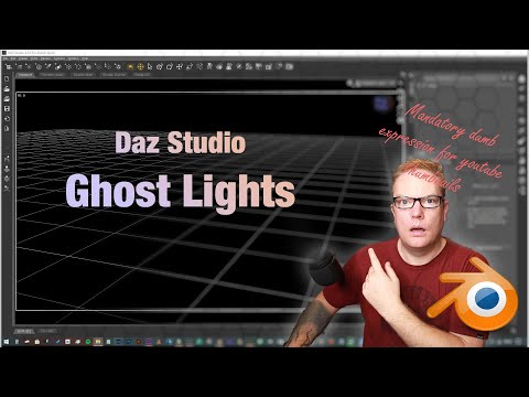

  • It's possible you were thinking of Ghostlights, there are a few products in the shop here based on that system.  It's basically a prim, such as a plane prim or a sphere prim, set to .0001 opacity (or some other tiny percentage like that, I'd have to look) with emissives set.  I've used these frequently, though there's also tutorials online on how to make your own ghostlights.  Here is a thread about making ghostlights, also.  There are also Youtube videos like this one:
    ...and this one:
    Pretty sure I remember there being at least one tutorial online somewhere else, but can't find it in my saved links at the moment.
