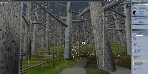

I have about a half dozen surface replicators attached to my ground surface, generating all kinds of vegetation. Everything was fine until this morning, when I started editing the trees, to make them look more natural. (!!!)
At that point, the replicators stopped obeying the distribution masks, and just sprayed trees all over (the other replicators started doing the same with their plants).

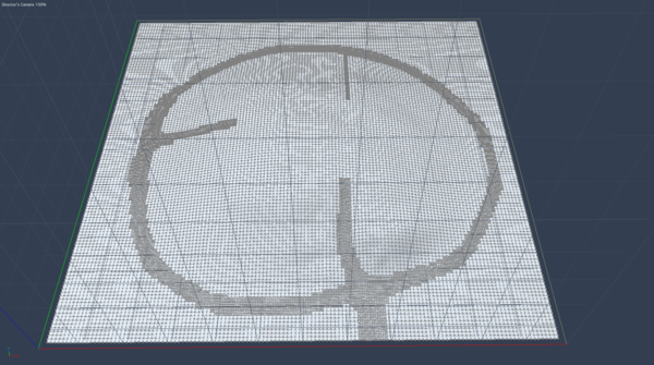

The ground is a vertex object, approx 22,000 polys, in a nice even grid, which has been sub-divided where the track runs, for more detail. UV map looks fine. The distro mask restricts the trees to the hill portion (ie inside the circular track, and has wide clearways where the track runs, for decent line of sight etc)

    I've tried all those. Brand new replicator, different distro map, Restart carrara, restart Mac, different numbers in the boxes, don't use shader, do use shader, good/best/fast, cluster/don't, align to normal/don't, all domains/ground (there's only one shading domain), remove unused masters...
    Nothing has made a difference.

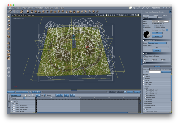

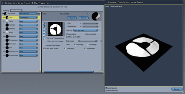

    No joy changing file type. I've added pics of the shader settings and a top down of the whole scene showing the tree placements. That's set to replicate 100, which is very sparse (the original setting was 600, which gave about 250 trees in the white area)

    Add to the list, I've tried deleting the hill and reimporting the original obj - no difference.
    Delete the hill and assign the replicator to a simple square plane - no difference.
    Hmmm... how about some screen shots of the actual replicator settings?

    One other image map suggestion, have you tried converting the image to grayscale from RGB? Is black, pure black, and white, pure white?

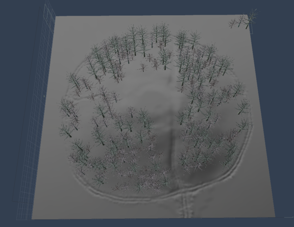

    Okay, the one thing I hadn't tried...
    Start a totally new project, add the hill obj, add some trees and replicate.
    Success!!
    (the three trees top right in a line are the master objects)
    It still doesn't tell me why the original replicators are not working, but if I save out all the objects from the old scene maybe I can get them working in a new one...
    And just to reiterate, everything was replicating perfectly, until I started editing the trees this morning. Obviously that's corrupted something.
