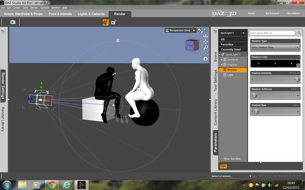

    Below is a simple picture I've set up, to show where I have the distant light and spotlight (distant shadow setting is off). I'm trying to get their shadows to stretch across away to the horizon.

    Try using Ray Traced Shadows. If the Distant light is to bright it may wash out the shadows created by the Spotlight, turn intensity down to 20% and set it to Diffuse Only.

    You were right, my distant light was too powerful it seems.
