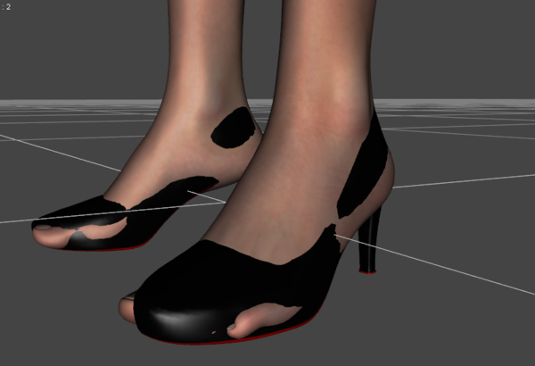

2. I have had a problem with creating a FBM for Girl 6´s feet.
The workflow for all the other characters was just fine, I created the FBM for them, loaded it and it worked but with Girl 6 and her feet,
after I loaded the FBM I created for the shoes, it looked nothing like it and the shoes looked even worse than without the FBM.

    About the Girl 6´s feet, here are the pictures.
    Picture 1 - this is what it looks like after dialing in the Girl 6´s body. You see that a FBM is needed since the default results are terrible.

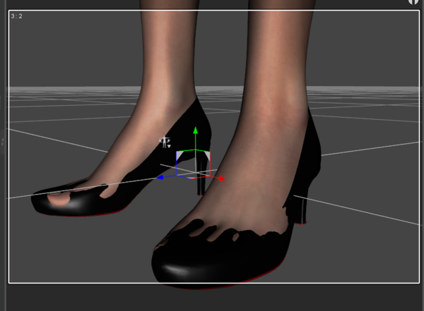

    Picture 2 - a fbm I have created for the shoes, I export it as .obj and name it FBMGirl6.obj

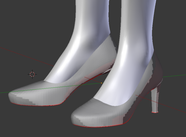

    Picture 3 - I import it via Morph Loader Pro with Overwrite existing set to Deltas and ERC Links and this is the result
    All he other FBMs I created this way for other character (Lilith, Victoria, Olympia, Aiko) worked just fine so I don´t know what the issue is with Girl 6 and her feet : )

    Using the Geometry Editor Tool, you can regroup the faces. You don't need to use the groups, you could just select the faces and assign to the left or right side. Switching the selection mode to Marquee or Lasso selection makes this much, much easier.
    Are your shoes modeled in the posed (high heel) position or are they modeled in the flat position to match the figure?
    If you modeled in the posed position, then I stand corrected with the whole reverse deformations question. You will need to do reverse deformations in order to get your morph to load correctly.
    If you modeled them flat, then we have a different problem going on that I need to figure out.

    Hello there again! Finally got back to solving this morph problem.
    I modeled them in the posed position and while loading FBMs for other characters, I did not need to turn the reverse deformations to "yes" and they work fine.
    But I just tried to load the morph for Girl 6 again and turned reverse deformations to yes but it did not work (see pic 1).
    As for the face groups, I think I finally figured it out. I´ll go ahead and try to create the poser companion files again and see if it works.

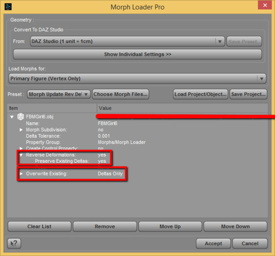

    Had a look at the shoes, don't see anything strange.
    Had someone else approach me with the same issue today, looked at their content and tried loading their Girl 6 morph in and it worked just fine with the settings you see in the attached image.
    As long as the following conditions are met, you should be able to load the morph just fine:
    - When creating the morph, pose the foot so the shoe is in it's ideal position and make sure only the Girl 6 Body morph is applied (the easiest way is to load G2F Base, not the Girl preset, and apply the morph). Export that and make your morph.
    - When loading the morph, make sure everything in DS is set up exactly as it was on export
    - Make sure the name of the morph is correct when coming in (FBMGirl6) so it can overwrite the existing morph
    - In Morph Loader Pro, make sure to set Reverse Deformations to Yes, Preserve Existing Deltas to Yes, Overwrite Existing to Deltas Only
    At this stage, the only other thing that can be done to track down this issue would be for you to post your fixed Girl6 morph here and see if anyone can load it in successfully.

    Hey there Josh and thanks for reply! After applying these settings when loading the morph for Girl 6, it loaded properly and now works.
    Then I tried to load a morph for Giselle which I just bought and I did it the old way and it worked as well.
    I´m glad it works but did you manage to figure out why is it that Girl 6 requires this special approach while all the other morphs could be loaded by just setting overwrite existing to deltas and ERC links?
  • DAZ_JoshDAZ_Josh Posts: 1,367
    No, I'm actually not sure why Girl has a problem and the others don't. She isn't doing anything obviously different from others.
