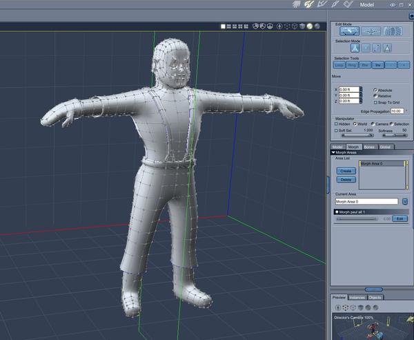

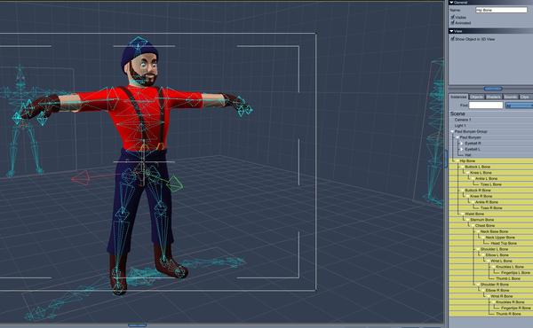

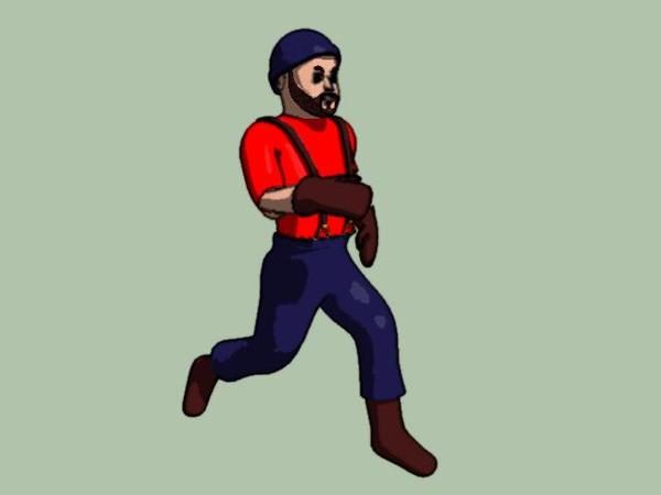

    If you know that you are going to render an original model in Carrara, then Carrara's native rigging can also have several other advantages.
    1) The rigging process is generally less tedious than some other programs because you do not have to assign polygon groups to bodyparts in the base mesh before rigging.
    2) If you create a morph in the base mesh before rigging, then you will be able to edit the model in the posed position using the animation mode in the top right of the vertex modeler. Such morphs can be animated. You can also adjust joints, etc in posed positions with the weightmap tools.
    EDIT: 3) it is easy to detach the skeleton from the mesh, make changes to the mesh, and reattach the skeleton to the mesh.
    In the attached, I have an original low poly lumberjack intended for a toon render. Everything is native Carrara, and it did not take long at all. If you add up all of the "File: export" and "File: import" commands if I had used Hex to model, uvmapper to uvmap, Daz Studio to rig, and throw in some time to assign polygons to bodyparts and edit textures, there is a lot of room for Carrara to be inefficient, yet still be a time saver compared to using other programs. But again, the key was that I knew I was just doing a low poly toon and had no intention of distributing the model, especially for use in other programs.
    So to what others have already said, I would add that if you know that you are only going to render something in Carrara, and you don't plan to distribute it for use in other programs, then rigging in Carrara can make a lot of sense under some circumstances. And in some cases (see Wendy's posts about where Carrara's rigging translates), rigging in Carrara can make sense for some external animations.
    1162 x 938 - 117K
    640 x 480 - 13K
    1446 x 892 - 195K
    1155 x 947 - 132K
    Post edited by Diomede on
