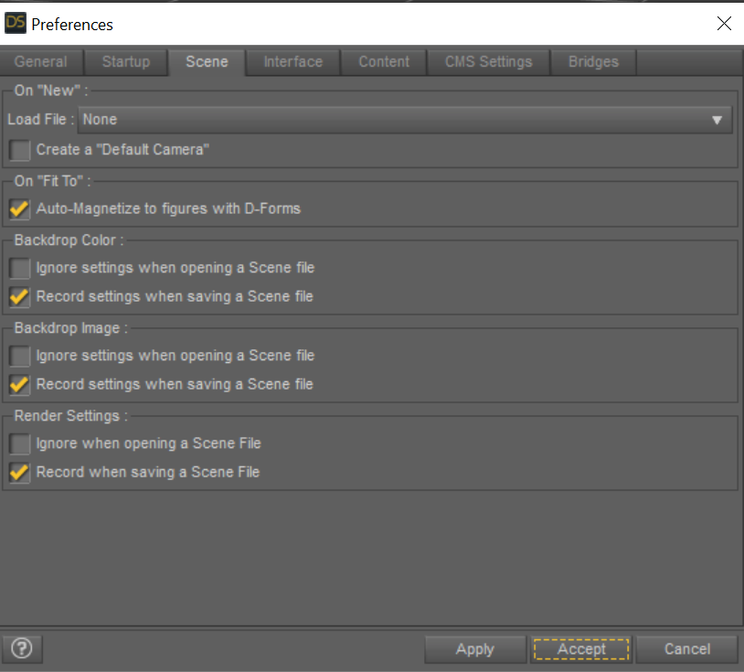

    You have to change the settings for saving your files. Under "Edit --> Preferences". In the "Pereferences" menu, go to the "Scenes" tab. There, go the "Render settings" at the bottom of the list, and check "Record when saving file" and unckeck "Ignore when opening scene".

  • Hurdy3DHurdy3D Posts: 1,109
    Thank you. Good idea, but these settings are unchanged in my setup:
    Must be something different what's causing this.
    814 x 735 - 118K
