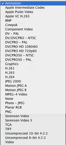

    Thanks I am on a PC. I cannot seem to find a codec that looks good on YouTube. When I do uv mapping tutorials for folks using Camtasia and render to Quicktime, it comes out pretty crappy. I assemble my animations in Magix Movie Maker 10 and cannot seem to find a good codec there either.
    What options does it give you when saving to a Quicktime movie? Personally, when I upload a video to Youtube, I use the least amount of compression possible. You still have to keep in mind Youtube's file size restrictions of course.
    The following is a screen shot of the codecs available to me, yours may vary somewhat. h.264 has good quality and lower file size. Plus it's a Youtube friendly format. The other screen shot is a simple compressor setting available with many of the codecs. You'll want to slide the slider all the way to the right for maximum quality. The empty box on the right would display a thumbnail image from the video if I had one selected. Some of the compressor settings can be a little more involved depending on the Codec. For instance DVD codecs will usually give you options on if you want a one pass or two pass encoding, etc.
    661 x 287 - 21K
    292 x 635 - 66K
  • UVDanUVDan Posts: 112
    edited September 2012
    Thanks. I do not have QT pro so I do not have the option of selecting compressors, but I have been searching for someplace to download the H264 codec. Is that only available in Qt Pro? My other option is windows movie maker which has minimal choices. When rendering out of Bryce and Studio, I always go with full frames no compression. I recognize Cinepak as one of the codecs available to me though. and Indeo also.
