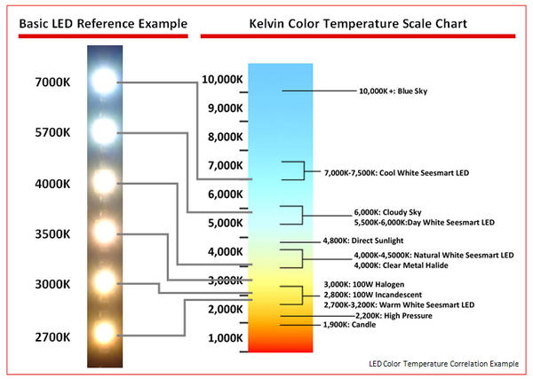

    You need to do a little research on "Color tempertures" for lighting.
    As mentioned the Reality/LuxRender unbiased renderer can help set it up easily,
    or with DAZ Studio use some more yellowish-orangish lights to emulate incadescent.

    Funny you mentioned this. In an earlier iteration of my reply included the comment of looking for 2.8K to 3K color temp, but I thought that might be too obscure.
    I'm actually pretty familiar with color temps as I have used 10k MH bulbs for my corals for many years, and supplement my orchids winter light with 6.5k MH.
    However, thanks for the recommendations of renderer plugins. Daz is a great program, but it is easy to get lost with all the plug ins/options.
