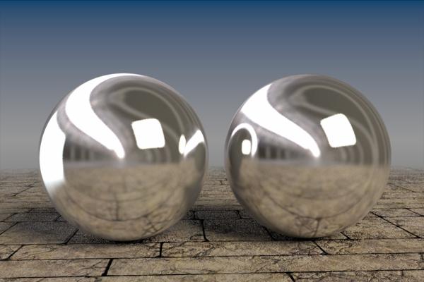

    liking those check boxes.
    render test
    1053 x 800 - 696K
    1053 x 800 - 721K

    That's a really nice effect. Think I'm gonna try that out.
  • PhilWPhilW Posts: 5,162
    A good demonstration of how much more real adding blurred reflections makes the image.

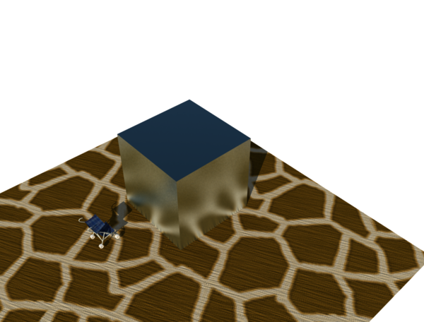

    You could also try a low intensity noise in the bump channel instead of enabling blurry reflection, which will render faster (how it works in real life)

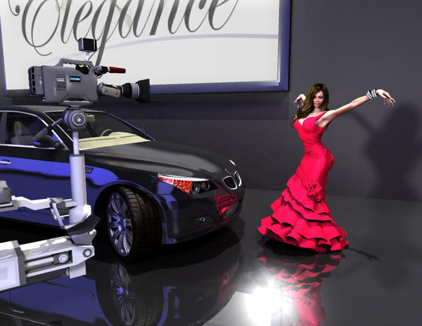

    Here's an example of what NOT to do with reflections... :) :)
    Here I made a very reflective floor. And the reflection is fairly reasonable for the type of material that might be used...a highly reflective linoleum or plastic or some sort of tile.
    The problem is that the reflections are perfect, indicating that the floor is almost mirror like. Now I've seen at auto shows where they do place vehicles on a mirrored floor so you can see the cool chrome underside of the car. But in this case that's not the intent. The surface is intended to be a highly reflective plastic or linoleum, which is, by definition, slightly wavy and uneven with corresponding wavy reflections.
    Notice how the reflections on the auto are closer to what you'd expect...uneven, and following the curves of the car body.
    So the next step, IMO, is to modify the floor shader to resemble a non-perfect, slightly wavy floor material.
    Oh, and fix the horrendous, out-of-the-box shaders on the camera equipment... :) :)

  • AquilaAquila Posts: 19

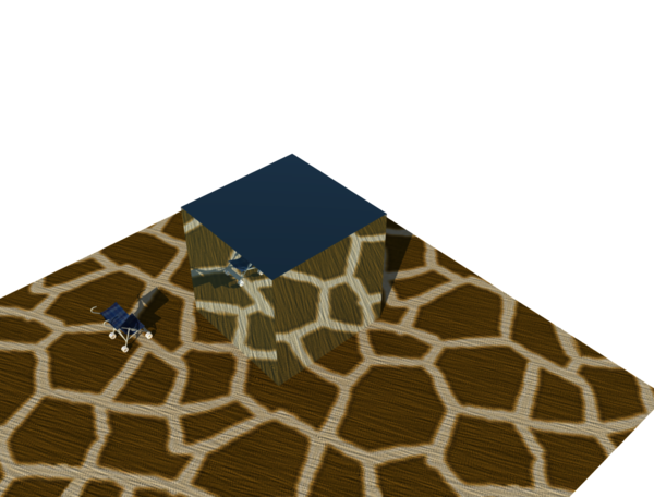

    Just a very quick example but you get the idea (highlight and shininess set to none)
    blurry reflections rendered in 20 minutes 21 seconds
    noise bump - blurry relfections disabled rendered in 2 minutes 22 seconds
    1000 x 667 - 427K
    1000 x 667 - 327K
