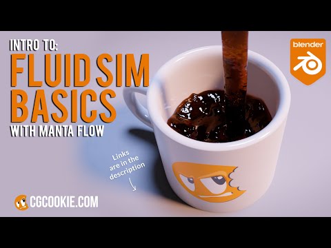

Follow this video:
(You can ignore the part about materials, since you'll be re-applying those in Daz Studio. Also, don't move the beaker from where it's imported.)
Pick a frame where the liquid has a nice flow. Make sure you have only the fluid domain selected, then convert it to a mesh by applying the fluid sim modifers. Then export it as an obj, making sure to set the scale back to 100.0 (or 10000%) and to tick "Selected Only". You don't care about exporting the beaker, since it already exists in your Daz Studio scene. All you want is the fluid.
