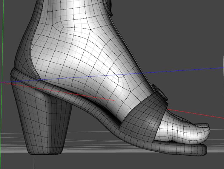

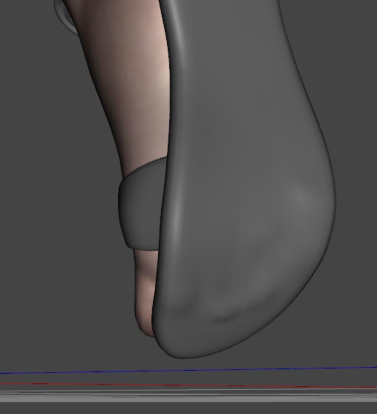

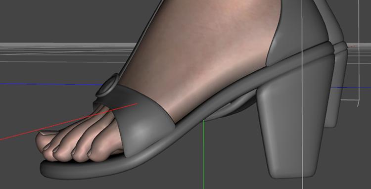

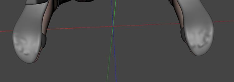

Hello guys,
I am rigging my first shoes. As a guide I use this great tutorial of Allen Renfeldt Rigging High Heeled Shoes in DAZ Studio for Genesis 3 - YouTube   The process includes using Transfer Utility, baking geometry, apllying  and zeroing pJCMs and JCMs. (You can also find the short text version of Allen's rigging tutorial here Genesis 3 High-Heeled Shoe Creation - Google Docs )
It works great except one thing: every time when I repeat the rigging process I get warped soles. Please look at the pictures.
For some reason I am unable to get a smooth surface. The soles of my shoes have bumps and dents. Not good! The logical solution would be to fix them using weight maps. Believe me, I tried it. For some reason, playing with weight brushes makes the surface even bumpier.
I have a feeling that I am doing something wrong. I remodeled my shoes and changed the pose of the feet. There was a hope that if the feet are further away from the soles, the soles would stay smooth. Nope, every time I get the same result.
However, when I look at the products made by PAs, I see that their shoe soles are smooth and beautiful.
Why do I get so mush distortion on the soles in the toes area? Can you help me? What is wrong here?
763 x 838 - 115K
750 x 342 - 68K
750 x 263 - 51K
750 x 382 - 102K
750 x 567 - 206K
Post edited by Eternal Force on

    The distortion happens in the toe area. What can cause it?
  • I think this is happening because in effect the shoes are not in the zero postion - as modelled - but have been automatically converted to the zero pose from the high-heel pose, then baked to the real zero pose, so there is some distortion from the posing applied. The method given should avoid that with the high-heeled pose, but it is still easy for weight irregularities to cause issues. Unfortunately the fix is probably to smooth the models for the zero pose and update the geometry, then work on the weights and JCMs for the posed state.
