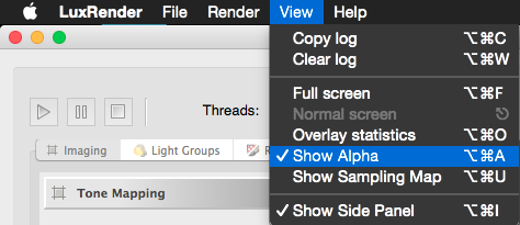

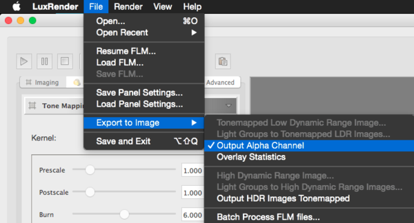

  • StratDragonStratDragon Posts: 3,290
    this can be done in the LuxRender interface as well if you a) forget to check the box, or b) use something other than Reality
