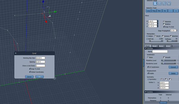

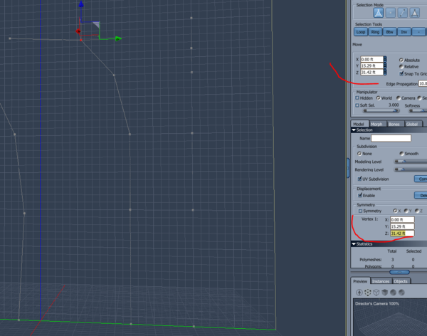

i have the working box size/drawing plane set to 30ft. spacing .5ft
the snap to coordinates, was assuming, would all be ##.00 or ##.50
it is snapping as i drag with the manipulator, but offset from the grid lines.
trying to get them precise for a double sweep operation.
started marquis selecting individual verts, in case clicking on em nudged em.
was typing in each verts x and y coordinates textbox to fix the decimal numbers, fixed 10 already, but it's much work >.<</p>
what can i do to constrain the verts snap to the grid line? is there a tolerance setting?
i searched the file preferences and c7 manual, nothing looked promising
thanks!
tried changing absolute to relative in the move settings.

  • de3ande3an Posts: 915
    If you have created an outline using the Polyline tool before activating the "Snap To Grid" option, then trying to move the vertexes via the "Manipulator" will, as you have noticed, maintain the offset from the actual grid lines.
    However, if you grab the vertex by the point, rather than by the manipulator arrows, it will snap to the grid lines when you move it.
    Be sure that you are working on the active plane while moving, or else the point will end up someplace unexpected.
    Choose your active plane by using either the Camera List or the Active Plane Tool.
    If I draw with the Polyline tool with "Snap To Grid" enabled, I find that for me, it properly aligns each vertex with the visible grid.
    Hope that helps.
