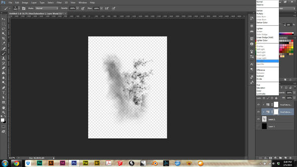

HI guys,
My Photoshop inexperience is rearing its ugly head here.
I've purchased Ron's Smoke Brushes, and I'm trying to do his Smoke to Fire tutorial, which is basically add a hue/saturation layer, with a certain color, duplicate it, and then set them both to overlay.
Here's my issue: I can't set the layers to overlay. All the contrast blending options (Overlay, Soft Light, Hard Light, etc) are greyed out and I have no idea why.
Also, it doesn't seem to matter what I set the hue/contrast settings to, it always comes up red.
I tried looking for an answer first, but I only found multiple explanations of what the blending modes do, not why some would be greyed out.
I'm using CS6 - haven't upgraded to CC yet.
Thanks for any and all help.
-C

  • crifmer_a3ace2ba16crifmer_a3ace2ba16 Posts: 37
    edited February 2015
    But that's the thing. I *can* change the blending option, just not to Overlay:
    Can you check the mode? Go to Image>Mode and see what is selected? I think you are in 32 bit mode from your screenshot and some layer functions don't work with that setting.
    If it is 32 bit, try changing it to 16 bit or 8 bit and see if the options un-grey.
    Post edited by MarkIsSleepy on
    Nice. That was the problem, thank you.

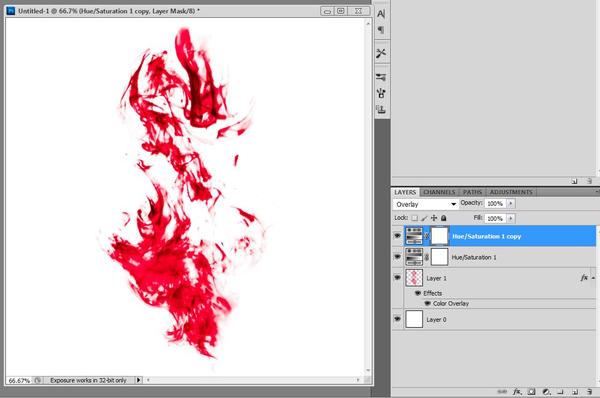

    Awesome - I'm glad that worked.
    Now I'm curious what was supposed to happen though. :)
    I followed the steps you posted above and got... a result. It's cool, but I'm not sure if it's what you were going for. The only changes I made were that my brush was red when I added the smoke. I also added a color overlay to the smoke layer - changing he color in that layer style created a bunch of interesting effects.
    Mark
