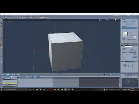

Who does not know what Swift Loop in 3D Studio is, here is a very clear and intuitive video.

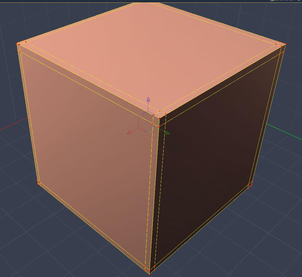

    1877 x 864 - 221K
  • would this work?

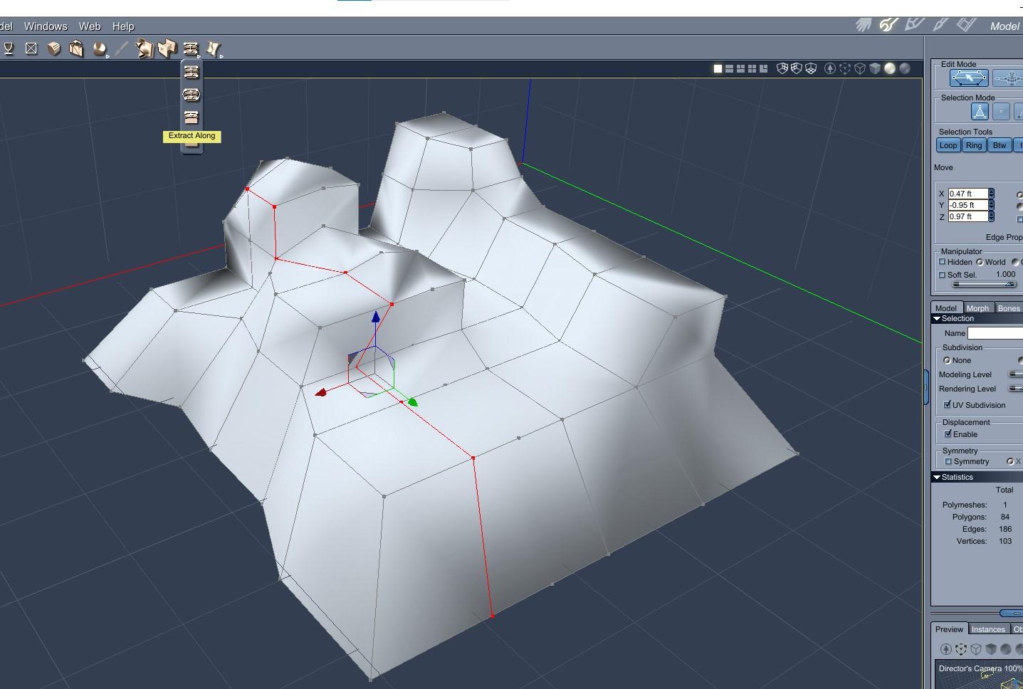

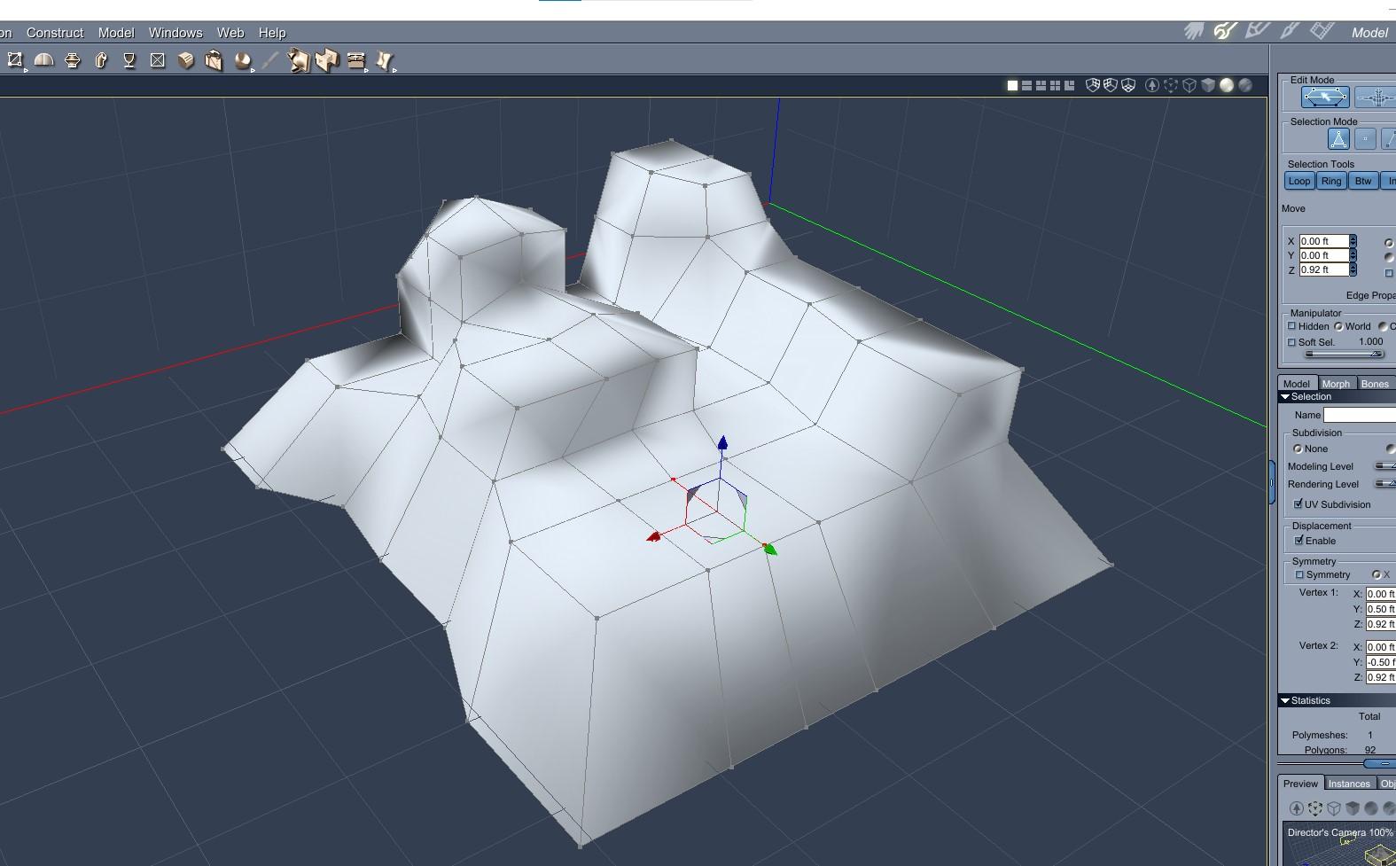

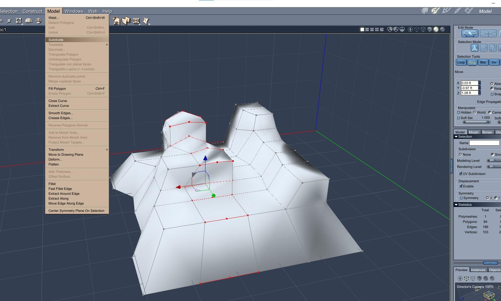

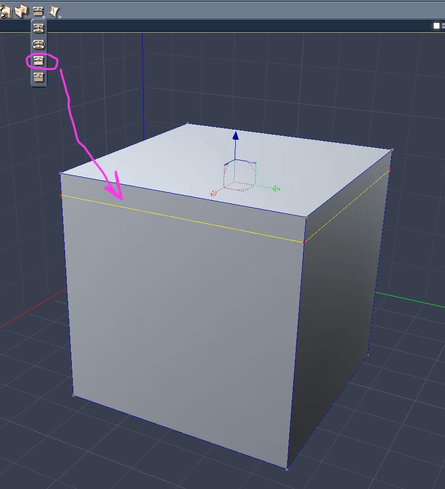

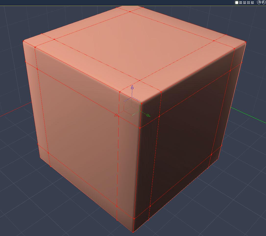

    But...I think it does...the Extract Along tool? Third one down. This is what I did to re-create the cube example in oandr88's video:
    Insert a cube, then for example in the first screen grab, I selected the top polygon, selcted the Extract Along tool, then one can drag a loop in either direction. The yellow loop is what I got after using the tool.
    I did that for all six sides, working in opposites, top / bottom, left / right front / back.
    I converted all edges to smooth using Model > Smooth edges, then turned on smoothing to level 1.
    Lastly, I hit the 'convert' button and turned on smoothing level 1 again.

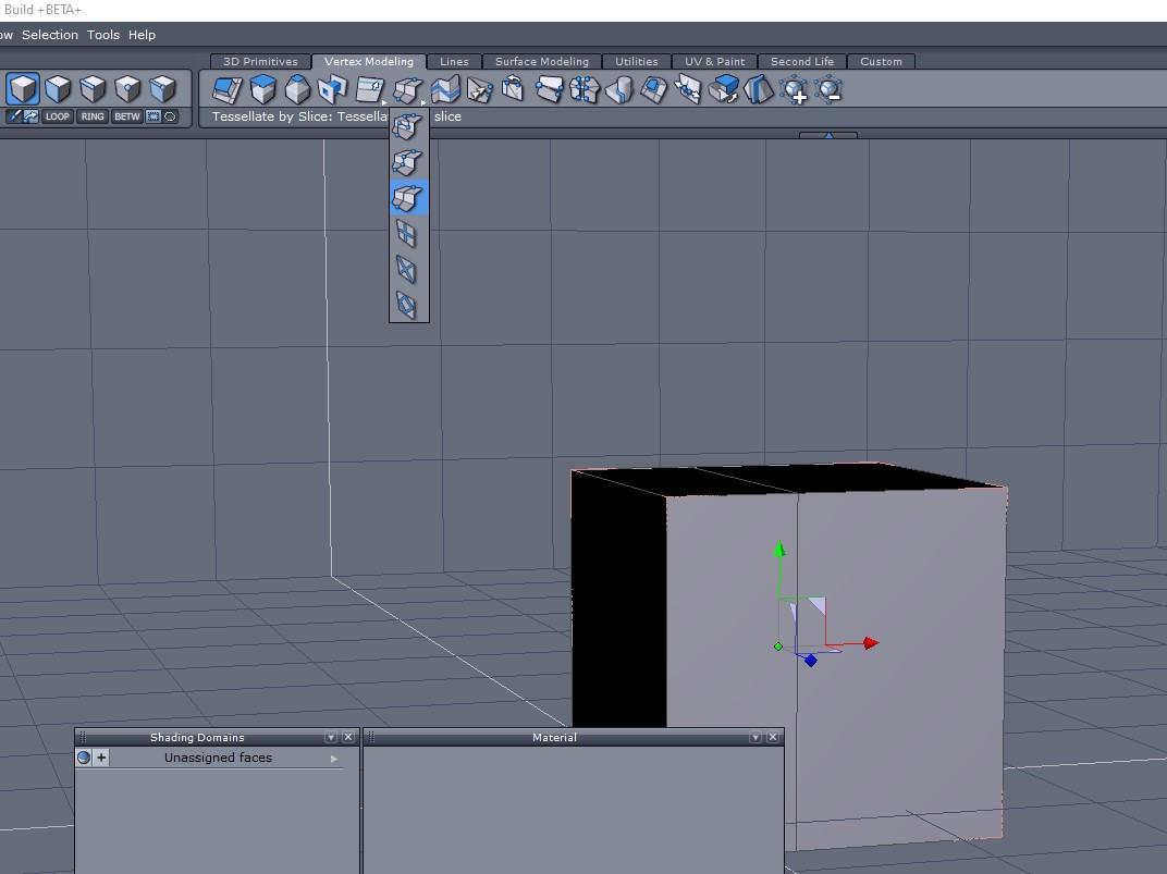

    In Wendy's video (clever demo Wendy! smiley) she uses the Extract Around tool found in the same menu, second icon down. You can try that on your stair step example where two planes meet:  select the edge, use the Extract Around tool and you will get 2 loops, one on either side of the edge. Then you can mix and match Extract Around and Extract Along as you see fit.
    edited October 2021

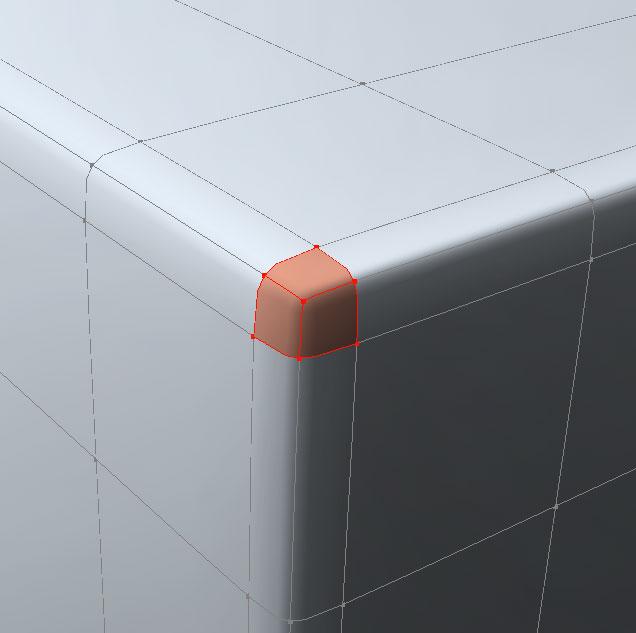

    These tools are very similar, but they are not quite the same.  To use the 'Extract Along' tool, you first have to select a the full loop next to where you want the edge loop.  Then extract along from it to one side or the other.  A related tool would allow you to simply click anywhere on the interior of a line and create an edge loop perpendicular to where you tapped, extended in both directions for as long as there is an opposing parallel line to be cut.  In many cases it works out the same, but consider when the lengths of the edges to be bisected are not the same.  Does the new edge loop extend inwards for all of the edges to be bisected the same distance from a previously looped edge?  Or, does the new edge loop bisect each edge to be bisected the same proportion from each end point?
    It doesn't make that much of a difference for simple cubes, but if you have a complex model or a flowing organic model it can make a difference.
    EDIT - here is the 'Tessalate by slice' tool in Hexagon.  Very similar to extract along, but not quite the same.
