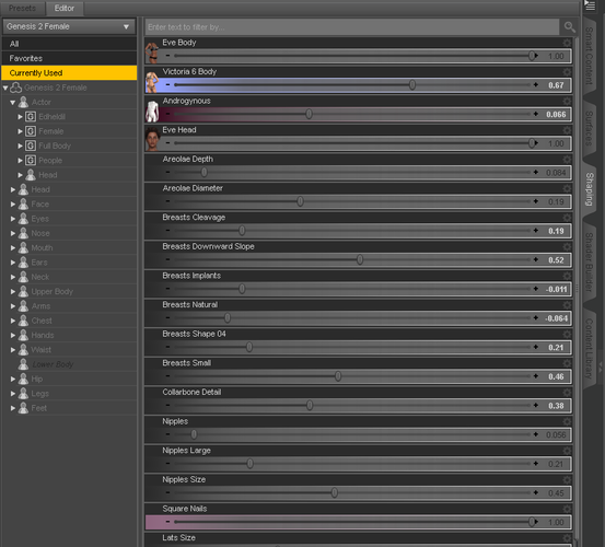

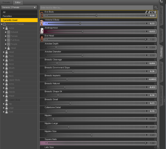

    Allot of other figures also use dials to augment the custom (z-brushed) shapes. They do show the sliders used as well as the 'Master' slider.
    For example, FW Eve, has a Body 'Master Control' dial, and the other dials used are there as well. Now at rare times, it can be annoying, and sanity-saving at the same time, wen a dial is 'reset' and it dose not go to zero, rather to the default setting according to the 'Master control' dial for the Body or head.
    As I have discovered when trying to make a few nose shapes, there are shapes, that dials don't exist for (yet possibly). So I can also understand your point with not having a dial that is needed to do something.
    Here is Eve, shown with the 'Body' dial at 100% and at 50%, the other dials do move accordingly with her. She is NOT an On/OFF figure by any means. Another reason I've used her so much when testing other stuff. (EDIT, and NO, that is not all of the dials for her.)

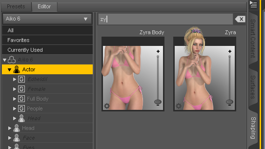

  • LyonessLyoness Posts: 1,641
    strangely... actor/full body is for body only dials
    for all in one (head and body), it goes under People/*

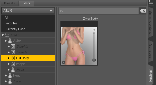

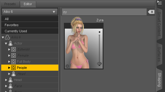

    edited February 2015
    uh, yea. I think. whom have I not picked on so far here.. Zyra body, and Zyra full. Under 'Actor'.

  • TaozTaoz Posts: 10,346
    Ok, but what I meant was the body only dial under Actor only, and not in Full Body. As far as I can see, the Actor category contains all the dials in all its subcategories, if that's correct, it makes sense.
    Jasmina's combined body/head dial seems to be placed correctly, since it's under Actor and Actor/People, but not under Actor/Full Body
