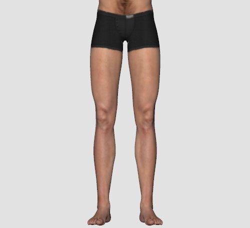

  • WandWWandW Posts: 2,905
    Here's a quick render with legs length at -1. It works fine at +1 too...

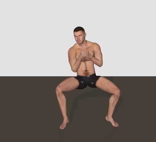

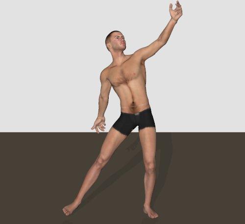

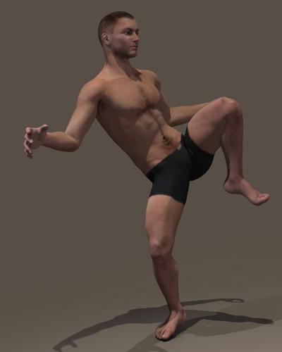

  • ByrdieByrdie Posts: 1,783
    The legs appear okay in these poses though the last (squat) does look a bit wonky near the tops of the thighs/butt. Which could be the morph but may also be normal in an unfixed M4 -- here I've only loaded the base and Morphs++, none of the bend fixes I usually use on him.
