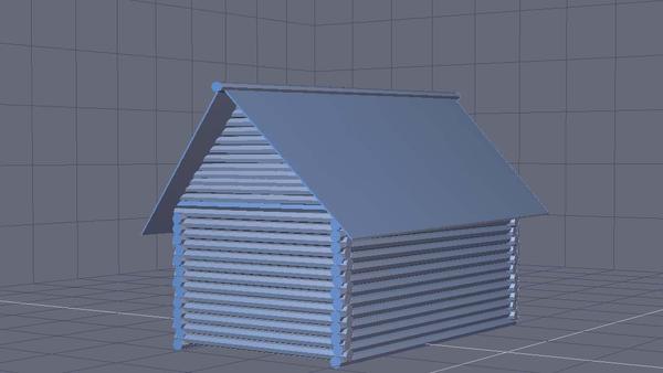

I am making a simple log cabin - following Geekatplay's Vampire House tutorial.

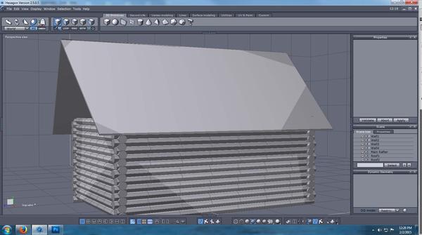

When I created and place the roof panels, I am seeing some kind of "phantom" surface on the roof & sides, that rotates if I move the model around...
Is this something I should worry about, or just a fluke in the display?
1613 x 900 - 130K
What you are seeing there are actual shadows. In the fourth group of icons from the right on the bottom of your viewport is a ball labelled "Shadows and ambient occlusion". That should be off by default. I suggest you turn it off - it really eats up resources.
Can't figure out why you have shadows on top of the roof - unless you have something above it which is not in the viewport?
Thanks - that worked!
No, there should be nothing other than the log cabin in the display...
Also, I've been trying to remove the lines inside the logs - they are the lines that show up when you make the original cylinder, maybe they are "cuts"? See the image...
I need to get rid of them because when I try to tilt the ends to match the pitch of the roof the entire end of the log - enclosed in the pink lines - bends...even when I have carefully selected ONLY the ends, which are sealed. In the tutorial the lines are gone, so just the end tilts...
I'm sure it is a very basic procedure, I just haven't found the tutorial that shows it!
The tuts are great, if you can follow what he is doing - but in many cases I have to stop and backtrack the video to see what buttons he selects...and the hot keys never display! My 72 year old eyes just don't work that fast...LOL!
I think I follow what you are getting at - the transverse lines are sections. When you first create a cylinder, you will see in the properties panel options for Pts/sec and Sections - the default is 8 for each. The Pts/sec refers to the vertical edges - the more you have, the "rounder" the cylinder will be. The Sections refer to the number of horizontal cuts. If you don't need the cylinder to be sectioned off, set that to 2 - the lowest it will go.
To get rid of the sections at this stage would not serve much purpose, except to make the model lower poly, but won't achieve what you are wanting, as I understand it. If you really want to, select one edge of each of the section cuts, loop and hit the backspace key. You then get a dialogue asking whether you want to dissolve vertices - hit "Stray only". You will have to do this one cylinder at a time.
To get the ends of the log to match the slope of the roof, you need to be in transparent mode, with one of the other selection modes active (the pic shows you are in object selection mode, which selects the whole cylinder) . Select the end of the cylinder and rotate to match the slope of the roof.
I am rather surprised that someone shows this method in a tutorial, because it will distort the cylinder ends and you will have to scale and move to get it back into shape. An easier method would be to simply select the verts (points) which protrude and scale them inwards.

OK, I should have been clearer - I am referring to the vertical lines that divide each log.
These appear when the cylinder is created, but at some point disappear.
Select/loop each unwanted section line and hit the backspace key. In this case, select "all".
I would recommend keeping one in the centre. And after you've tilted the ends, loop that line and extract one line in abit. If you don't when smoothing is applied it will look like a pencil stick.

I was able to select the edge, loop it to go around the log, and backspace did indeed remove it - thanks, I missed the use of backspace to do that. I'm really new to this and I may have seen it someplace but it slipped away.
I then did the tilt to match the roof and it looks good!

If you look along the line of the group of icons I referred to in my post, you'll see various display options. He has his set to "smoothed solid" - in this display mode, it shows the geometry when selected, but not when not selected. which is why the lines appear and disappear as he works.You have yours set to "smooth solid and edges", which displays the geometry whether selected or not. This has no effect whatsoever on the modelling process - it is merely a display.
If you look very closely, when he rotates the ends of the log, they do deform, but this is minimized by making a very short extrusion and then hidden in the roof mesh.
Good luck with the rest of the project - it can be daunting when trying to follow a tut where no every move and click is not explained.:)

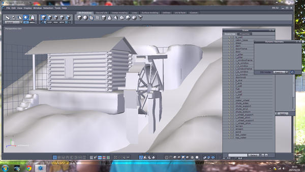

Here's a pic of a log cabin I did for a Bryce challenge - I ran out of time and never completed it. The cabin is made using a totally different method than shown in the tut, so I could have space between the logs for the caulking. Each wall is a single object.

Thanks - that's somewhat the same as mine. And being able to add caulking is a great idea...maybe next time.
