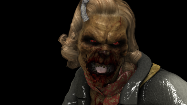

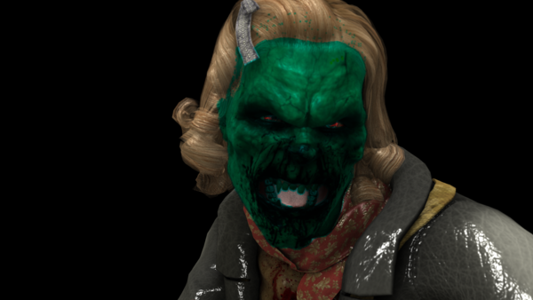

Help! There are some strange render artefacts in some images of a sequence that I am rendering.
I put an okay rendering and a troubled one. 39 pictures are okay, but two are weird.
Which option do I have to tweak in DAZ in order to get rid of them?
PD: If I render the same image again, the same green face appears.

  • Richard HaseltineRichard Haseltine Posts: 112,010
    Do you have lights with Depth-mapped shadows, or no shadows?
  • FetitoFetito Posts: 481
    Ummm, where do I check that? (I am not at home right now and my ISP crashed for days)
    I used a preset from "Core Lighting 1" http://www.daz3d.com/core-lighting-1
    Shall I change to raytraced shadows?
    Try, yes - it's in Shadow Type on the light settings, and I've a feeling at least some of those light sets did use mapped shadows.
    Yay! I'll try so once I get home. I have ISP-issues right now, so I will reply tomorrow if your wise suggestion has success. :)
    @Richard Haseltine: Yay! You rule! I changed it to raytracing. Issue has been resolved.
    What happened what was wrong?
    Depth Mapped Shadows have had issues for a while - it's a 3Delight (or possibly a Renderman in general) issue, though I'm not sure why it hadn't been apparent until relatively recently. That seems to be part of the motivation for getting the performance of ray-traced shadows up.
