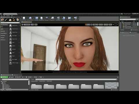

  • Someone made a tutorial for swapping out the eyes.  Hopefully it has all the info you need.
    https://www.daz3d.com/forums/discussion/434292/using-the-unreal-engine-eye-shader-with-daz-characters
    https:/Some /www.daz3d.com/forums/discussion/434292/using-the-unreal-engine-eye-shader-with-daz-characters

    YES! That's exactly what I was looking for. It works like a charm. Thanks so much frankiev888_28!
