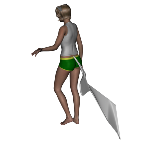

My second problem is illustrated in the file I uploaded. I can get the cat ears and tail set and posed, but they will not take any of the color choices. Which is slightly annoying, though I would like to make them a different color than the three included. I don't need stripes for the character so if I could just give them a single color that would be perfectly fine.

    My second problem is illustrated in the file I uploaded. I can get the cat ears and tail set and posed, but they will not take any of the color choices. Which is slightly annoying, though I would like to make them a different color than the three included. I don’t need stripes for the character so if I could just give them a single color that would be perfectly fine.
    Select the item that you want to change the colour of in the Scene pane, then go to the Surfaces pane, and change the 'Diffuse' colour to the one that you want.

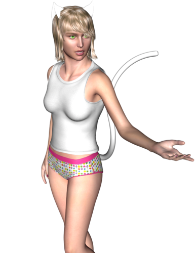

    Alright, found the menu you were talking about for changing the color and getting the shader to work. Still a lot of tweaking to do and learn, but that was a big help. Thanks.

    Okay, got one more question. Is there a way to get the cat tail to work with Genesis 2 figure? The auto fit doesn't seem to work with the tail, but it works fine with the ears.

  • Steven-VSteven-V Posts: 727
    I've not used the tail or ears props, but my experience with auto-fit is, if it is not a typical, standard item, like a shirt or pants, it will warp or mutate when you try to auto-fit it. The better option is to just load it into the scene without the character selected, and then parent (but NOT fit) it to the appropriate part of the figure (in this case, I suppose hip or pelvis). In theory, once parented, the object *should* follow the part of the character's body to which it is attached.
    However, even there, I have seen issues with long/thin props like swords. You will probably have to do some manual adjusting if you have her move in very extreme ways (standing with a slight bend like you have pictured will not be an issue, usually).
    To be honest, I'm actually surprised even the ears worked out. The Catgirl set is actually a geograft for Genesis. A geograft actually replaces the geometry on the figure and tries to act as if its a part of the model rather than a separate entity. For that reason alone, autofit has a really hard time trying to get them to work since the geometry on Genesis and Genesis 2 differs significantly.
    As Steven said, your best bet may be to simply parent the tail to the figure's pelvis or alternatively use a tail designed specifically for Genesis 2.

    First of all, Genesis and Genesis 2 are completely different figures. You say you are auto-fitting Aldora hair to Genesis, but you must be using Genesis 2 as the Aldora hair fits correctly to Genesis and there is no need fro the Autofit menu to appear. If you want a perfect fit for clothing or hair, then use the hair that is made for the model you are fitting it to. Autofit does it's best, and works well with most things, but it is only ever a workaround.
    Genesis is one figure, also known as Generation 5, Genesis 2 comes in both Male and Female versions (2 different figures), and is also known as Generation 6 or G2M and G2F.
    I can change the material on Aldora hair easily, even when it is Autofitted to Genesis 2 Female, but you MUST select Aldora Hair in the Scene pane before double clicking on the Material file, then it will work.

    It worked so well on the ears that's why the tail confused me so... And while knew they were different, I did not think they were that different. Oh well, little more surfin the forum and playing around is the only way I am going to learn.
    And Jimmy you are correct, I got the two backwards in my post.

    Genesis and the Genesis 2s aren't that different in the since of the mesh (genesis 2s have have more polygons in some areas) and rigging, but all 3 are different figures so that triggers Auto-Fit. Auto-Fit works by projecting the figure's bones/rigging to the item being conformed or Fit-To it, in the case of items that have a bone/rigging set-up completely different then the figure these item get mangled by Auto-Fit.
