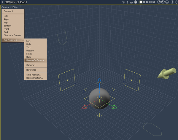

    Also. to build your scene, try using the Director's camera. It is not a render camera and doesn't generate key frames. If you come across an angle you like while using the director's camera, you can leave it where it is, use the camera pulldown menu and select one of your rendering cameras, such as Camera 1, and then use the Set Position to... Director's camera.

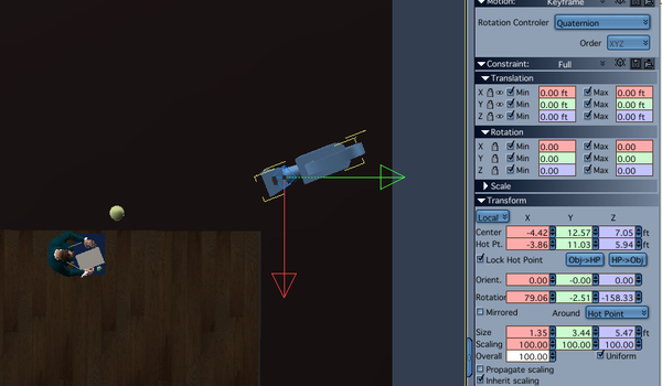

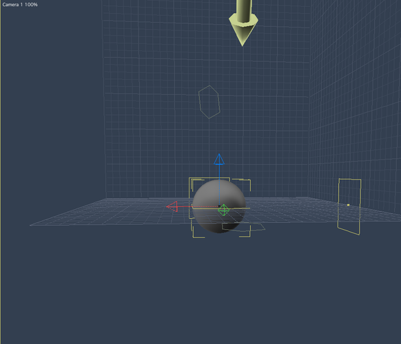

  • starboardstarboard Posts: 452
    Ii don't want to move the camera because I want to make a number of clips on an alpha so that I can composite them in AE. In between shots I want to be sure that the camera has not moved. It is true if you are careful and don't move the camera you can pull it off. However, sometimes you can move the camera just a little and not be aware that you have done it.
    I have the conical camera and I have locked every thing I could get my pointer on..but no matter what the camera still moves when clicked and dragged. Why is this...It should be locked right....At least that was what happened in my old program.
    Thanks again for the time,
    Starboardtack

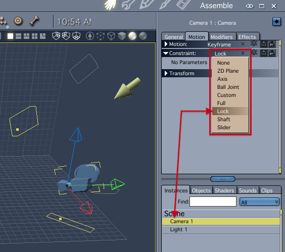

  • de3ande3an Posts: 915
    Here's the setting that you want.
    564 x 499 - 71K

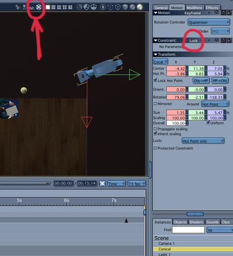

    Thanks Everybody,
    De3an suggestion helped , I selected lock as suggested but the camera still moved when clicked and dragged. However when I clicked on the "use Constraint" icon, that did the trick. It is odd that it takes that much to lock a camera. A combination of both.

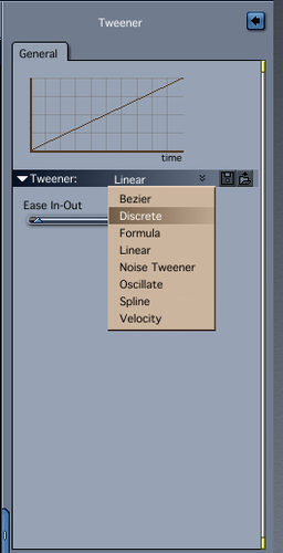

    Saved camera positions, like nearly everything else in Carrara, are keyframe-able.
    If you switch between the two positions at frame 0, then no keyframe will be generated. If you advance along the timeline and select the second saved position, Carrara will animate the camera moving from the first position to the second position. How the camera is moved between the two keyframes is determined by the tweeners. The most commonly used tweeners are probably the linear and bezier tweeners. If you need an instant switch of positions, use the discrete tweener. With the discrete tweener and using your camera as an example, the camera won't move from the first keyframe until it hits the second keyframe in the timeline, then it will instantly jump to the position that the second keyframe defines.

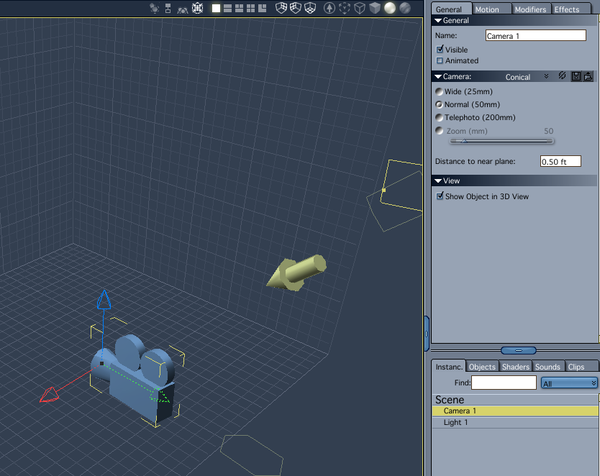

    As mentioned by others, you lock the constraints on the camera, but if you decide you don't like the angle and want to change it, then you have to unlock the constraints. However, there is another method that will allow you to move the camera without generating keyframes, and that is to simply un-check the animation checkbox in the camera's General tab. The camera will still be able to be moved, but it won't animate. It will simply render from the last position it was moved to.

    there's also an animate check box. maybe toggling it off won't generate keyframes?

    Hmmm... Constraints are usually on by default. They must have been turned off accidentally.
