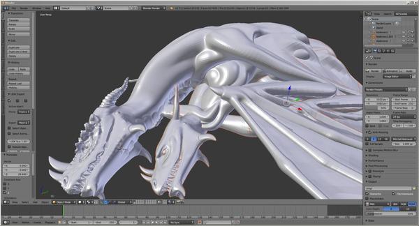

    well I just tried with and without on dragon in my least favourite app Blender
    you can see the difference

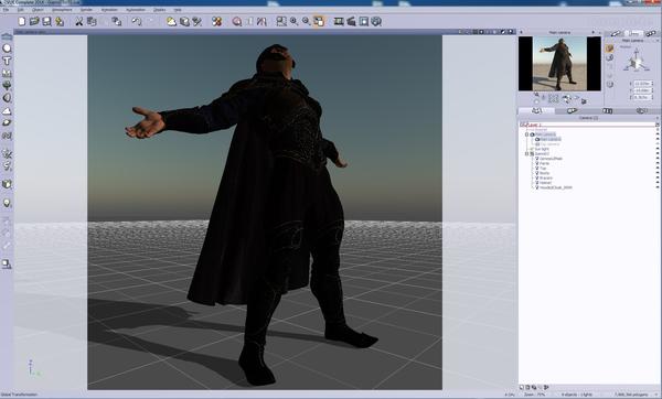

    I have just rendered Wildenlander HD in Vue Complete 2014 and it looks like it takes HD morphs for clothes (looking at polygon count).
    I have not edited materials in Vue, so one can get even better results then.
    In Daz Studio I have set subdivision level on clothes to 3 and then exported as .obj

  • H. J. ValdiH. J. Valdi Posts: 98
    Thanks for the images, Artini. Good to know the outfit works okay.
