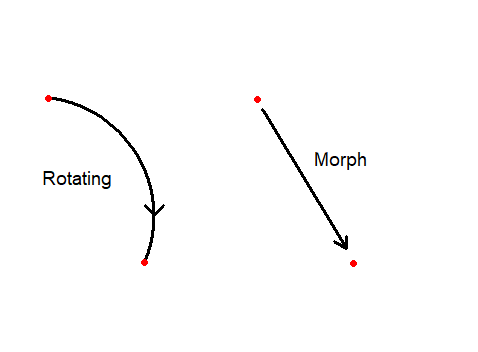

    visually...
    478 x 352 - 4K

  • DiomedeDiomede Posts: 15,469
    a picture is worth a thousand words.  yes

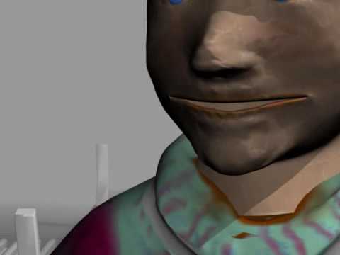

    this guy might have  bad problem walking but he is all morphs
    (103) USING MORPH TARGETS for Anim8or walkcycle - YouTube
