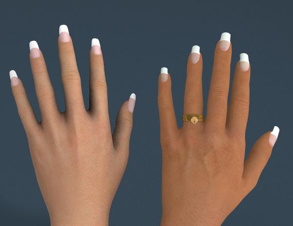

    See the render below, On the left I have G2F with Wicked Fingernails Long-Square set, and on the right, wearing a ring, is V4 with a square nails morph I got somewhere. Note that the G2G nail shape is better, especially where they meet the fingers but have an almost oval shape due to the rounding off I mentioned. I would like a true straight nails morph but I suppose there is no way to get there, unfortunately.

    Try changing the SubDivision algorithm to Bilinear.
  • ChangelingChickChangelingChick Posts: 3,453
    Alternately, you can change the resolution to base instead of high.
    Silver's characters Clair and Zahara both come with a squared nail option that (with either fix above) will be nice and straight. The other characters of Silver's that come with square nails (that I have) also work with either of those fixes.
