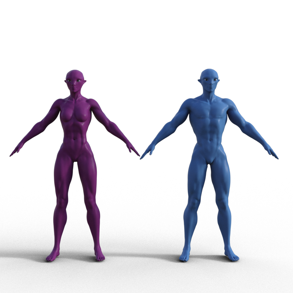

    It went well - on the 1st try even :-)
    Following your instructions I also:
    In my usual fashion, loaded into the scene both G8M and G8F, removed all eyelashes and set figures to base resolution, render subD Level 0, and I leave subD level at 1 [1 or 0, either setting normally lets morphs be created].
    Dialed in what's likely a popular morph for G8F.
    Set that morph into the Favorite Category by clicking on the little heart.
    On the Transfer Utility, ? "remove unused bones" I unchecked that box too.
    Clicking on Morph Targets to get the extended options dialog for it, From Source "Favorites" - unchecked the other 2 boxes.
    Post Transfer Options: uncheck everything.
    Click Accept.
    It took. Dialed in morph, returned figure to high res etc. Polished morph and saved it for in case I ever want to have what was referred to as a "nursing father" for some Biblical scene.
    1006 x 805 - 100K
    1558 x 815 - 432K
    Post edited by Catherine3678ab on

    In trying this procedure in D/S4.16 with a full character shape morph, when matching the rigging to figure, the mesh VANISHED. It is not supposed to do that. So I went ahead with the steps like it was still there and saved the alleged morph on the awol mesh. Reloaded the scene, the morph WAS THERE but the rigging had NOT adjusted. So I asked again for the rigging to be adjusted and it was. ERC freeze worked too. Resaved morph. Reloaded scene.
    Nothing is always as simply as one expects/hopes it is or should be. In the new morph there was a serious glitch so an adjustment morph was made to take care of that.
    Update: and then for unknown reason D/S claimed the duplicate error message when loading a new figure. Sigh.
    So back to drawing board: Got it working finally.
    Tip: Before telling D/S to adjust rigging to shape, "save the morph" ... then adjust rigging, do ERC, then save the morph again. Apparently there are times when the rigging is what may cause serious glitches in the newly morphed figure, so I made an adjustment morph but this time instead of having one dial the other in [and then get duplicate error messages], I remade the morph A with B, and saved the final working morph. It now loads as it should and I have a male and female Drax figure. And there will be no .pdf tutorial on how to do this.

  • is there a new method? this seems outdated and does not work.
  • crosswindcrosswind Posts: 10,322
    Transfer with Morph Targets + Clone always works...and you don't need the option of Use Near Vertices because you use no projection.
    After transfer, you just further dial G8F Clone on G8M... so as to have 100% same shape on G8M with the transferred Head / Body morphs dialed. Then you can further export the full character morph to OBJ, Zero G8M shape, load a HeadSplit DFormer on G8M, and import OBJ with Morph Loader Pro to separate Head / Body morphs again.
    Alternatively, you can use Fit Suit method  >  https://youtu.be/kXssz90XFEA?si=FyjrKwAaHXlxMVDB
