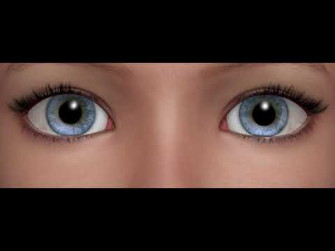

First for reference, this is how it looks with the old method, where the Iris has no highlight or reactivity at all   (I should note for clarity that the eyes have no reflectivity on at all, the bright specular glint is simply the highlight from the light hitting the cornea as I moved the light source from side to side in front of Aiko):
As you can see, the Iris does have a tiny bit of light sensitivity, but overall not much is going on.

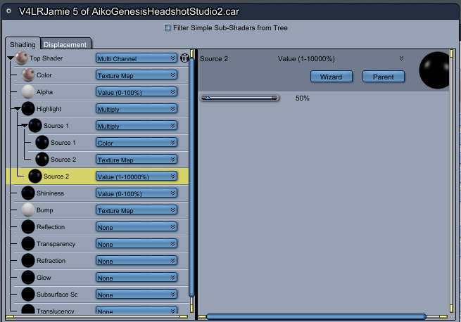

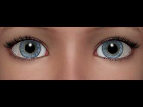

Now here's the shader I've been experimenting on, where the Iris has a 50% brightened highlight in a very specific way (screenshots will follow later to show):
Note the 'iridescence' that makes the Iris glint?  I think it gives oomph to the eyes and lends a little depth.
I don't entirely claim this idea as my own, I got the idea from working on a Carrara analog to AoA's Subsurface Shaders for Anime.  In that product, one of the options is to activate an Anisotropic shader for the Iris.  I did a little googling and found lots of references to the anisotropic nature of the human iris, although nothing definitive on how much, so I could be wrong.  But still I thought: 'hmmm, anisotropic eh'.  So I also tried the same method, but within an Anisotropic shader:
I was expecting the effect to be more pronounced, but instead its more subtle.  I think the non-anisotropic version has a bit more punch, so I'm leaning towards it.

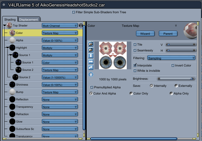

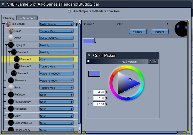

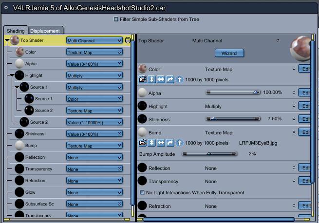

Anyway, here's the screenshots of the method:
I should also add that for different colored eye textures, it's as simple as changing the color multiplier by only changing the hue, which means simply picking a different point on the outside of the color wheel that corresponds roughly to the color of the eye you're using.
