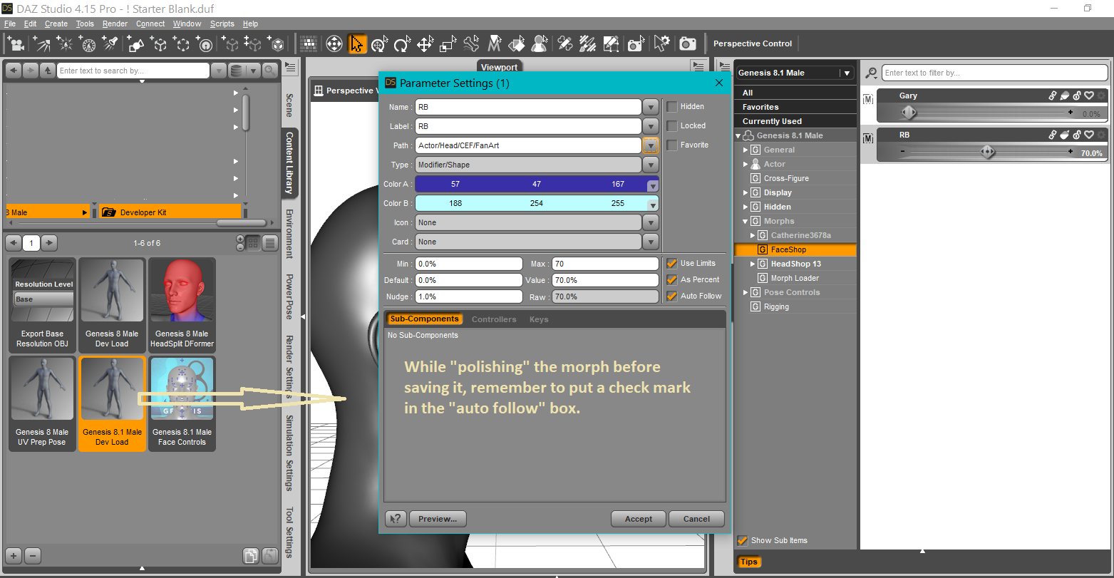

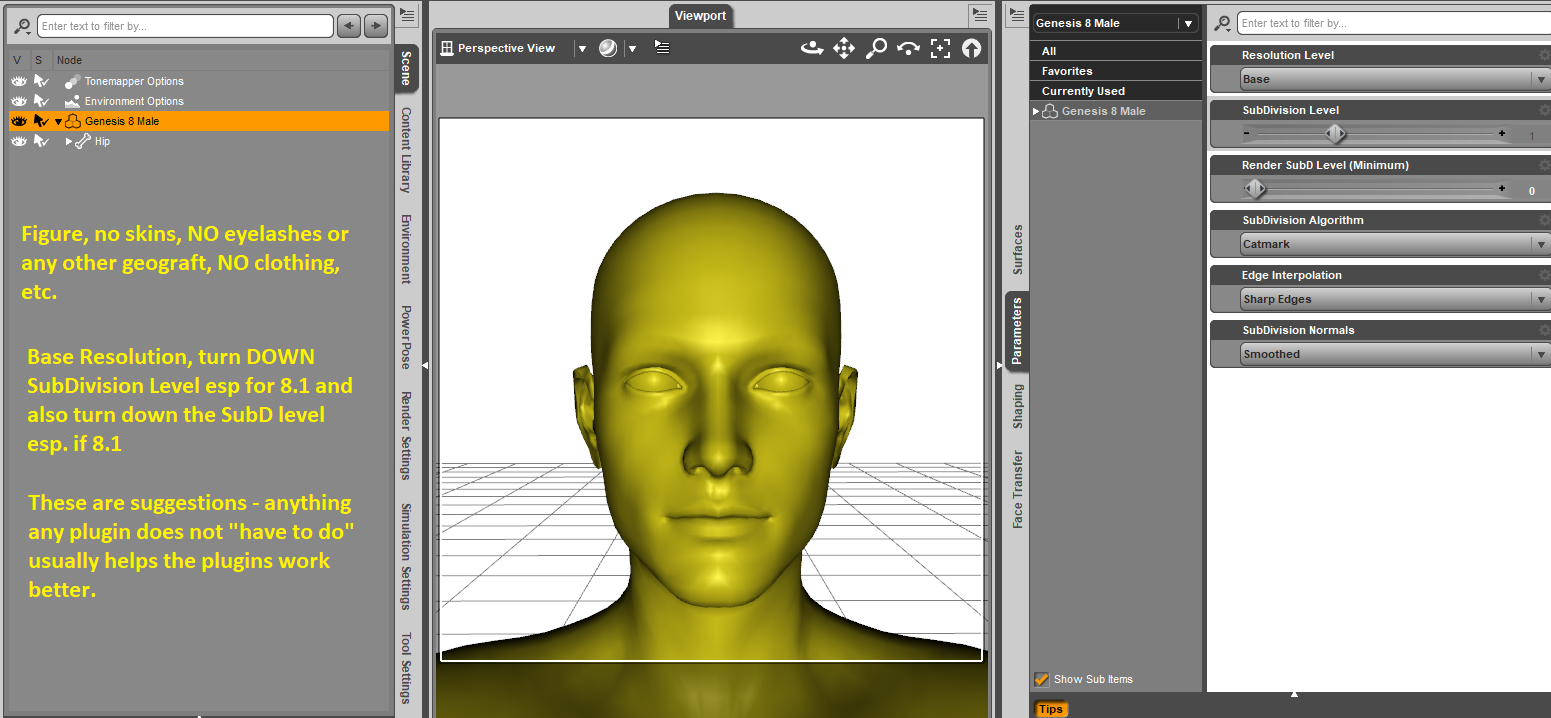

    Before running any of the Headshop products, remove the eyelashes. Make the beautiful head morph. Then over on the Paramters Tab as you're polishing the morph, be sure to put a check in the box for auto-follow. Then load a fresh set of lovely eyelashes and they should land where they should be on the figure. {zero the morph before saving it}.

    The plugin does make the morph. No plugin [yet] both makes and saves a morph. In the saving process one normally "polishes" the morph dial so it will work as desired. For example one might set the minimum value to "0" - change the colours of the dial, things like that. And while there, make sure the auto-follow is checked.

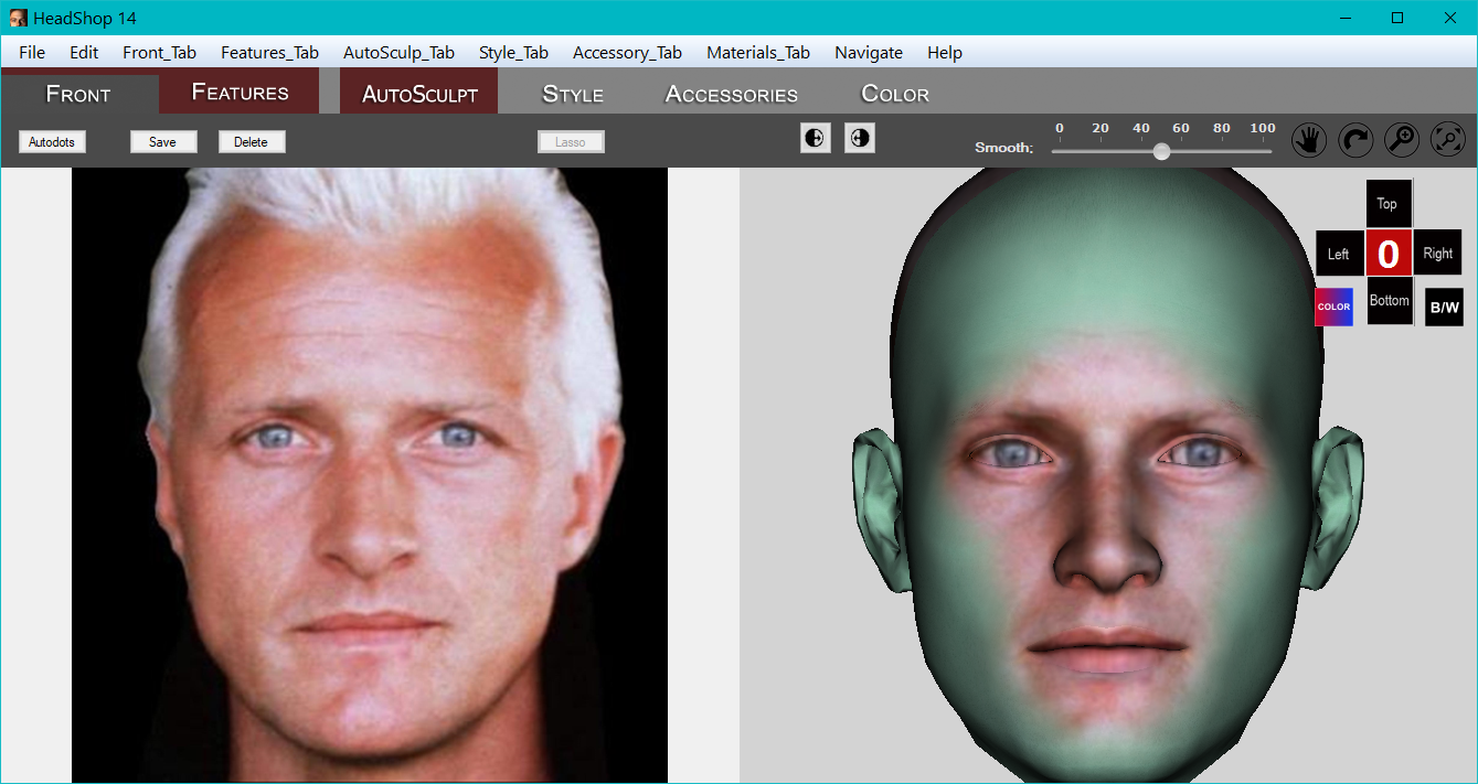

    Here's the little journey: {in HS14 I also added about 1/2 of one of the nose morphs} Final draft renders: used one of the Easy Portrait lighting presets, eyebrows from some character, Commander Hair, eye textures from 8.1's eye material product. {I delete the tear, it's annoying} {obviously replaced the skin - used a merchant resource}

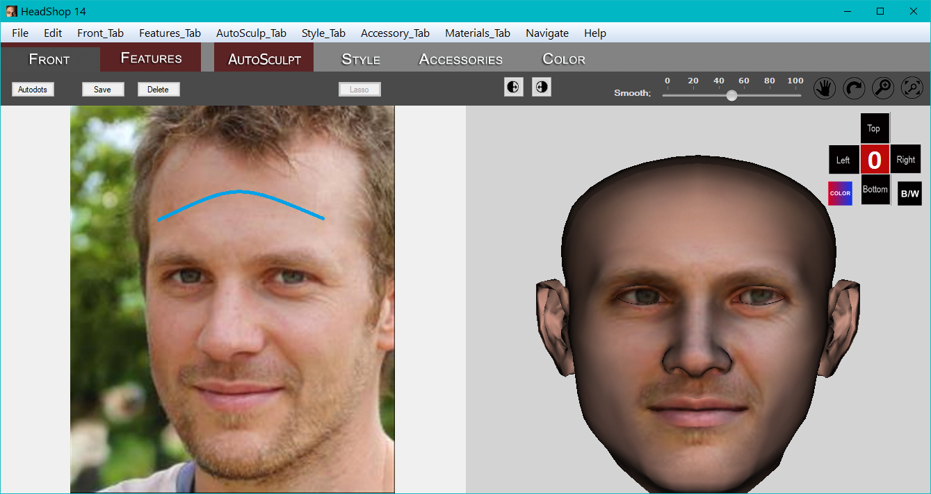

  • It was actually never clear to me where the Auto Follow box was that needed to be checked, thanks Catherine. That works well. I don't mind that workaround. The other thing I've been seeing with HS is that the top of the head is not natural. It comes from HS looking too flat on top. I've been using HS13. Is that fixed in HS14? Lately, I've also been seeing the noses come out rather distorted, even with a pretty decent straight-on photo. Anybody else seen that?

    Well I have noticed not all the morphs work as desired/expected. However most of them worked quite nicely if one takes the time to make proper morphs from them in the usual fashion [not through HeadShop]. As I recall there were one or two that require a little TLC clean up - I used the method of removing vertices from the morphs via the Favorite options.

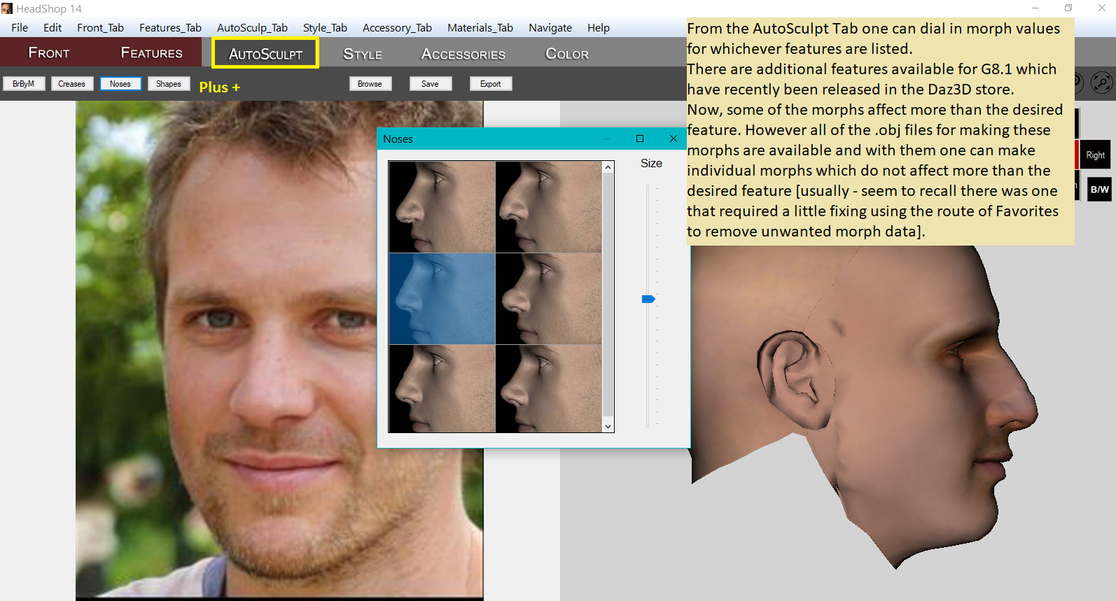

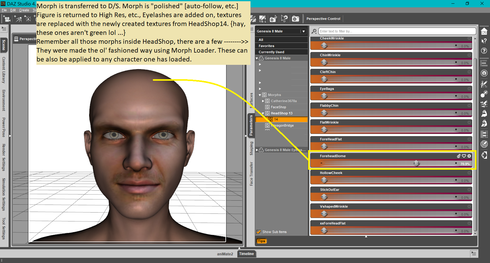

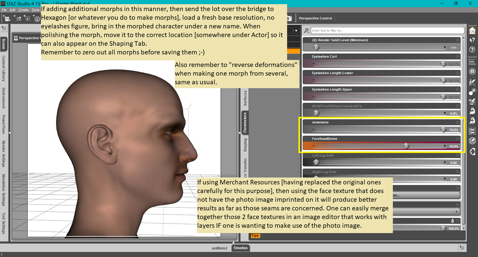

    One big difference with HS14 is that we can add in more morph options on the Sculpt Tab. For example the extra morph sets that were recently released in the store.

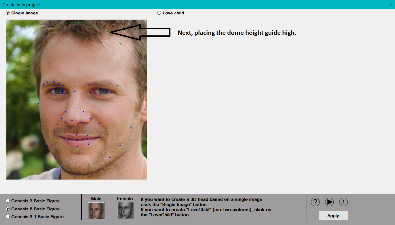

    There is a forehead dome morph ... I'm illustrating its use outside of HS14. Yes, I actually sat down one day and turned a whole bunch of those options into individual morphs.
    How I tend to start off morphing projects:
    {that is any character for the same base figure of course}
