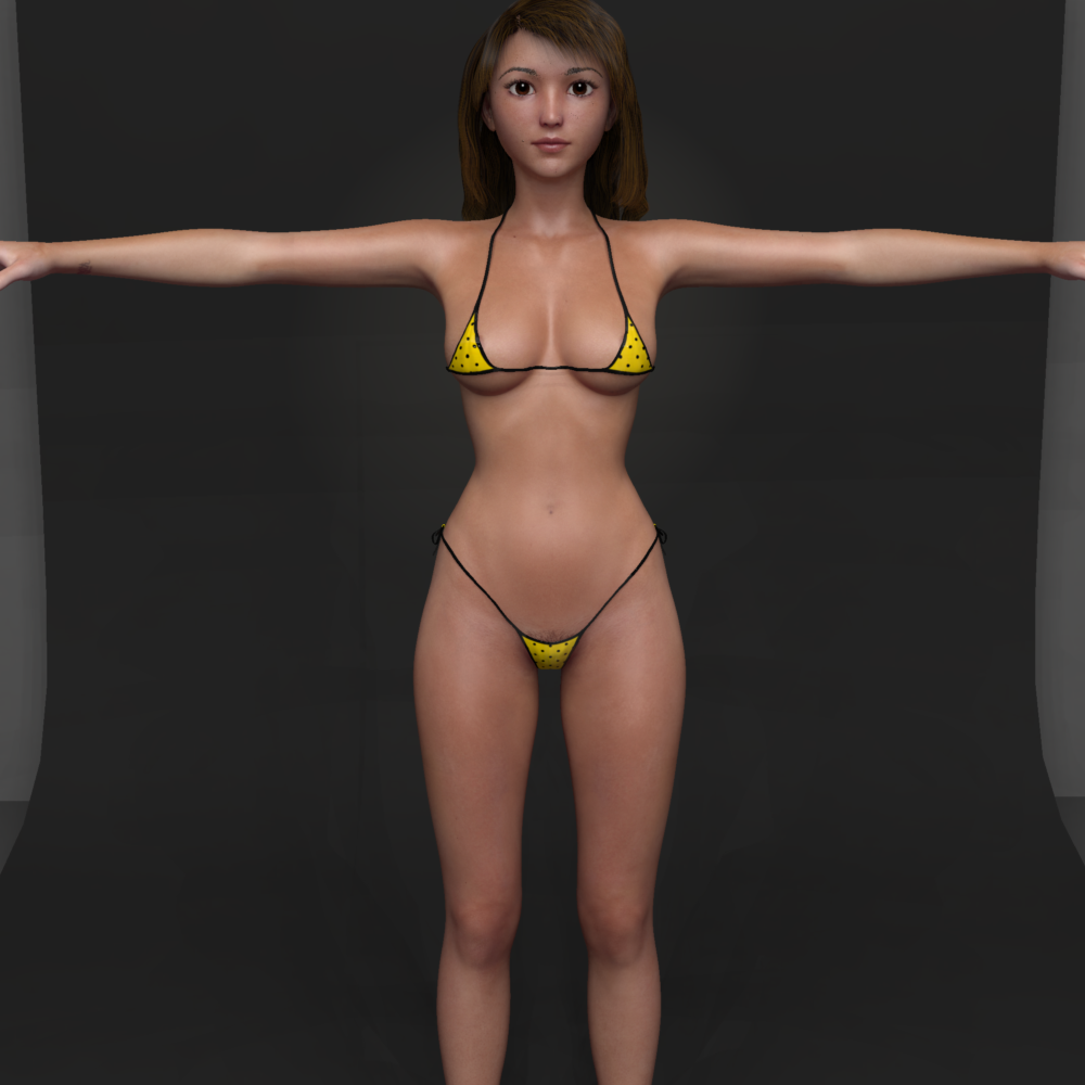

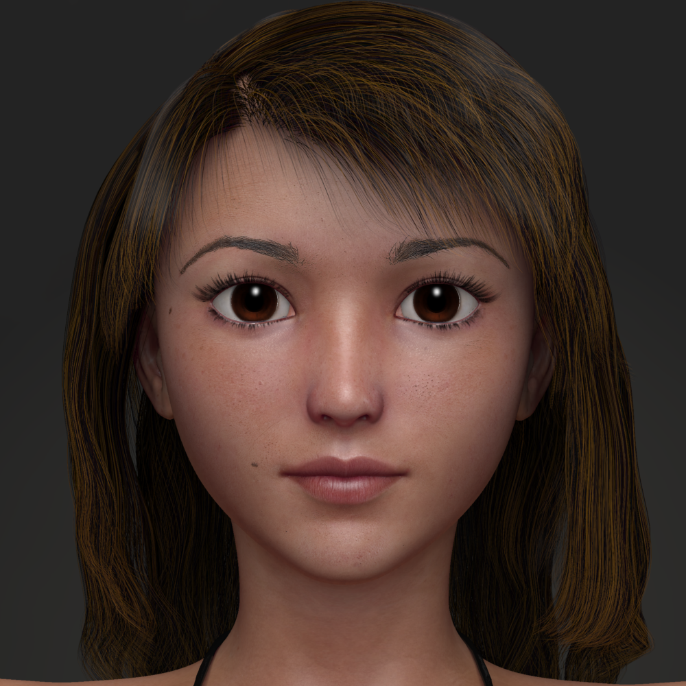

    Right on Stezza, that would work just as well, and probably better for those gifted with artistic eyes.  For me it's easier to see the percentages though and know exactly how much oomph I'm pouring into each side :)
    Since Dart mentioned Reby, I loaded her up on an Aiko5 and gave her the old heave-ho workover.  After a bit of fiddling, I landed on setting the overall bump amplitude at 20%, while the normal map is at 100% brightness and added to the bump map which is only at 10% brightness (Carrara is really really sensitive to bump maps I think).  After trying both the bump map and the normal map separately on a grayed out Genesis, it was clear to me that even the normal map I made with Materialize is very good at giving the eyebrows definition, while the professional bump map that came from DAZ kinda fails miserably.  Still the bump map is good at giving skin surface imperfections.  Of course bump eats up specularity (so does SSS, but that's a different story).  So I had to fiddle with the highlight levels a little bit to match, not sure I quite got there.  Honestly it's a cool experiment, but I'm not sure it's worth the trouble lol.
    Also I'm still not seeing the seams, so I'm worried my perception is failing me or that I did something different when using Materialize and didn't realize it. :(
    1000 x 1000 - 1M
    1000 x 1000 - 361K

    1 - I have a feeling that the seems I'm seeing from the normal map are due to her shape being vastly different from Genesis 1 - and I didn't always see them. I noticed them during animation renders. It might even just be an Octane issue, since I haven't tested the normal maps in Carrara yet.
    2 - Bump + Normal
    To combine the two, I'd suggest a multi-layer in the bump channel, so you can set the blending mode (Multiply, Add, etc.,) and opacity of each map individually.
    When I add viens using a bump map, I'll often just use the Add operator.
    Just take note that, when using multiple maps in bump, we often need to work more with the intensity slider of the bump channel to get the desired effect.
    Aiko looks good wearing Reby's skin! :)
