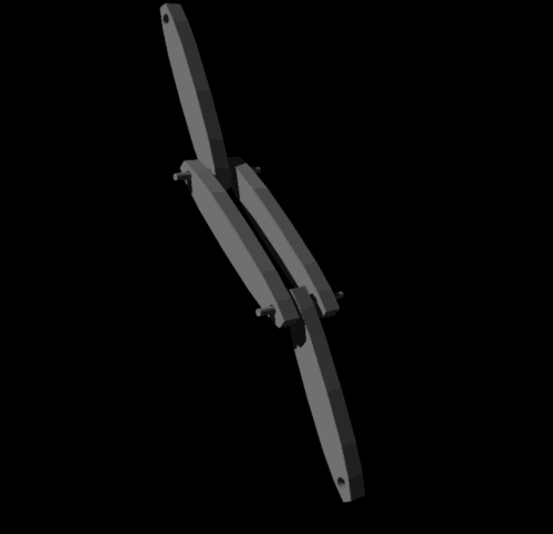

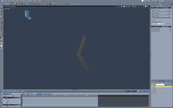

I'd like to use Carrara 8.5 Pro physics to simulate kinetic sculptures before I build them. However, I can't seem to get even the simplest linkage to simulate correctly. Please take a look at the very simplified linkage photos attached and tell me what I'm doing wrong. It consists of two linkages, one grounded but free to rotate and the other attached to the first. I've moved the hot points to where the pivots should be, and applied a shaft constraint, but as soon as I hit the Physics button, the linkages go every which way, not even close to what would happen in real life.
I'm sure I'm doing something wrong but I sure can't figure out what.
Any help would be appreciated. Thanks

    Do the two links intersect before simulation ? (it's difficult to see in the snapshot).

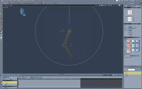

    Could you post a snapshot of the motion tab of the second link ? (the shaft constraint should be on the second one, not the first).

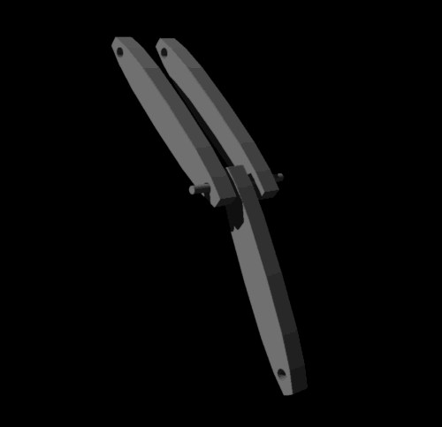

    Thanks for your inputs. I've attached photos of the side view at the start of the simulation. As you can see, I've put a fairly large gap between the two links so they don't "explode". I've also attached a photo of the motion tab of the second link, which is the same as the first link. I also have the second link a child of the first link. There are no forces acting on either link other than default gravity.
    Philemo, I don't follow your comment that the shaft restraint should be on the second link, not the first. I assume you mean the the first link should have no restraint. I tried that and they both just free fall out of the screen. Perhaps you could clarify.
