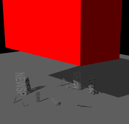

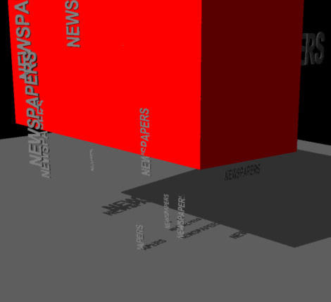

I've now tried everything: The built-in particle physics, Carrara's physics engine, as well as forces.
A word was used as the object particle, and it is emitted by the red box. Then they are supposed to fall down and fall over flat to the ground. But no go!. They fall, but when hitting the ground plane, most of them remain perpendicular and stick half-way through!
The ground plane was converted to a high count polymesh -- no go! Those particle words sticking halfway though, swirl around crazily as if they're trying to get unstuck.
I even used a rectilinear polymeshes instead, but they show similar behavior.
Advice will be much appreciated.
452 x 436 - 15K
470 x 428 - 21K

    Particles use the objects hot point as the collision point.....so you would need the text hot point at the floor end of the text.
    In my experience with particles, I have found that they tend to fall through objects unexpectedly, and since they will use the text hot point "AS THE OBJECT", they will go through the floor and no lat flat....(they have no volume)
    Particles have been on my wish list for improvement for a looooong time.
    Ahh...but thanks this mention about the hot point makes sense! I'll try it.
