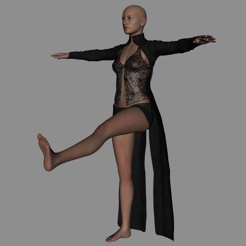

  • Cayman StudiosCayman Studios Posts: 1,145
    Cayman said:
    You ought to be able to move the corresponding bones in the cape independently of the body and in the opposite direction to the legs. A similar issue came up in another thread: http://www.daz3d.com/forums/viewreply/706297/
    That probably won't work. When I tried that with the Domino coat, it warped into a strange tangled mess the bones being attached to the G2F figure. I'm thinking the cape will work in the same manner.
    Well, here's G2F with Domino for V4 auto-fitted. You need to rotate the bones for the Thigh, Shin and Foot of the Coat to get it straight.
    800 x 800 - 98K
