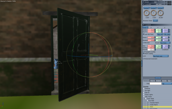

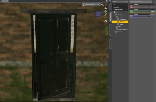

I'm trying to export a simple prop (a door) from C8.5 to use in Studio. The problem I have is that in Carrara, the hot point is at one edge of the door - at the hinge. But in the obj file, the hotpoint gets centred, so the door rotates around its mid point and not around the hinge.
(The issue happens even if I reimport the obj to C8.5, so it's an export problem rather than an import one). Short of adding an invisible counterweight to the door (!) any idea how to fix the export?

    You can solve this directly in DAZ Studio : select your door, activate the joint editor tool (ALT SHIFT J) and you have arrows allowing you to move the origin of the object in DAZ. Once done, save as figure/prop asset, and when reloading you should have your door with the origin on the right place.

    That does the trick - kinda like CapsLock in Carrara. Thanks :)
