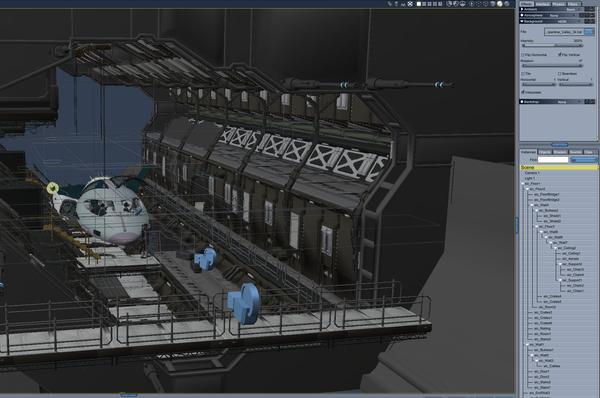

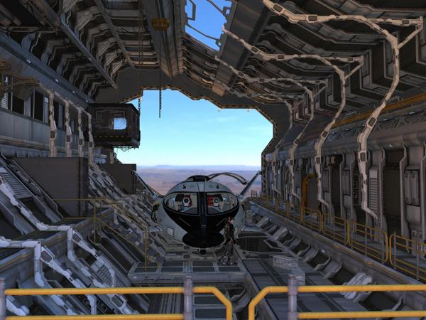

Heya all,
Every time i've tried using HDRI its really eluded me as to what settings to use and how to get it to work in general. Even some of the paid tutorials out there and youtube freebies, seem to scratch the surface, give you the basics then tell ya to have fun!
So anyways, I thought I'd try my hand at it again, having been on another long hiatus from Carrara... I picked up a few new pieces (well, something i seem to be always doing but never have the chance to really sit down and do anything with Carrara) ...
Scene Setup:
Ambient Light: Basic white 20%
Atmosphere: None
Background: HDRI - Serpentine Valley (freebie) , set intensity to 200%
Backdrop: None
Camera Depth of Field defaults - V4 Selected
Props:
V4 female (Nightworld Huntress and Complicated Eve clothing mix) - had her saved in my Objects from another project
Sci Fi Hanger
Shuttlestar
Added a single very low intensity yellowish distant light for some highlights on the V4, angled downwards slightly.
Rendering:
Full Raytracing
Gamma Correction 2.2
Antialiasing Good
Object Accuracy .5 Pixel
Shadow Accuracy .5 Pixel
Skylight: 1000%
Full Indirect Lighting
Light Through Transparency
Photon Count 10000
Lighting Quality Good
Accuracy 1 Pixel
Render time was about 14min on best quality on my rig (yeah, its a beast...)
So what am I doing right, and what am I doing wrong? Is this even worth posting?
Any hints, tips, or suggestions?
Thanks!
:edit: Added 2 more test renders - below the Assembly room screenshot, with toned down Skylight strength : 300% and 100% respectively...

  • Philemo_CarraraPhilemo_Carrara Posts: 1,175
    I don't know if it helps, but I've done quite a few renders with SIBLS sets.
    1. Usually, there is a high definition map (JPG or PNG), and a medium resolution HDR map. When the camera is set, I create a new scene, copy/paste the camera in it, add the hires background to the scene and make a render at least the size of what I'm planning to do (or more, usually twice that size). After that, I use this render as a backdrop in the initial scene (thus bypassing the limitation of the medres HDR).
    2. Most of the Sibl come with a Sun direction and color (You'll find it in the text file that is in the archive). This is something like:
    [Light1]
    LIGHTname = "Sun"
    LIGHTcolor = 249,220,189
    LIGHTmulti = 0.8000
    LIGHTu = 0.252000
    LIGHTv = 0.856000
    I have (somewhere) an Excel file to convert UV to direction for a directional light (I'll try to find it) but it's usually quite easy to find the sun with a few renders and align the light in opposite direction of the camera).
    From there, the light rig will be complete and you'll get highlights and shadows.
    3. Ambient light doesn't work well with HDR lighting and gamma correction. You should set it to zero. For instance, if you look to the boxes in the lower right part of the render, the boxes and the ground below have the same lighting and it's not good. There should be some kind of ambient occlusion and there isn't...
    3. Most of the time, full GI is superfluous when HDR lighting is on. You may try not to use it to speed up your render.
    4. if you plan to use GI, you may find useful to add a glow channel to the shader of the lights below the handrail. Considering how the scene is done, it's pretty normal the hangar should be very dark, with your character in the shadow and some inside lights would help
    Hope it helps
  • PhilWPhilW Posts: 5,162
    Looking pretty good to me! The one thing that I would do (as Philemo has also mentioned - in fact, all good advice from him!) is to kill the Ambient Light. This is a hangover from when computers were a lot slower and was a substitute for Indirect Lighting. As you are using Full Indirect, you don't need any Ambient Lighting and it will wash out your shadows.

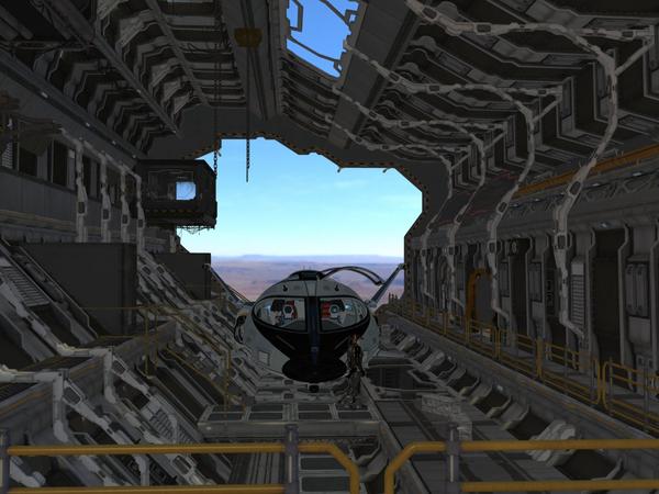

  • CoolBreezeCoolBreeze Posts: 207
    Thanks both!
    Philemo
    Yeah I generally do "LDR" type IBL as well, meaning using a spherical camera to render out the initial empty scene with the sun angle, often 8000x4000 pixels png format, and us that as my "skydome" ... Then I build the scene, use Sunlight @100% with Realistic Atmosphere with the Ambient set to Sky 20%, and in the render settings use full Global Illumination and the Skylight set to 300% intensity. Thats always proven great results for me. I've gotten near photo-realistic results and at worst very high end CGI quality renders. This is from a bit of tutilage from Tim Payne a few years ago.
    Ever since I started with Carrara 6.x many years ago, I've always gone the full GI route versus the faster faked methods. It does take longer yes, and in the case of my formerly 7yr old machine, alot longer. Thats always been my preferance tho.
    Using HDR i'm finding is a whole different ballgame i'm finding.
    I've also went in and found the materials that the Hanger lights are set to. Had to use a new shader, copy and paste the shared panel shader settings and add the texture to the glow channel. Thanks for the reminder, now we have lit hanger lights. Some of which provide some light around the immediate area.
    PhilW
    Ahh ok, I went back and set Ambient: Basic to 0% , kept the HDRI strength at 200% ...
    Now, in the render settings, I've set my Skylight to 100% , and then tried 300% (borrowing from the normal routine i always used with the "LDR" Full GI setup...
    Here's whare I have sofar... In addition I've added a second camera to the scene, one closer up to the character, to better see how the lights and shadows play in the scene...
    Obviously the slightly brighter scenes are the Skylight set to 300% vs 100% ...
    I'm still not sure if this is going in the proper direction yet or not...
    I also piked up Lux for Carrara, but I've been wanting to learn the right way to use HDRI with Carrara's native render engine first before learning yet a whole new render engine (went with Lux since I choose a pair of Radeon R9 290X's instead of Geforce Titans)
    1600 x 1200 - 171K
    1600 x 1200 - 139K
    1600 x 1200 - 243K
    1600 x 1200 - 190K
    Good results. I would be tempted to make the internal lights brighter by setting a multiplier on the glow channel and using the 0-10000% slider. You can try a few low resolution tests to get the balance right before doing your higher res final render. With Full GI on, you get the illumination effect from glowing surfaces as well as more conventional "lights" and it can often be the best way to light a scene (along with HDRIs which I find generally great!).
    edited January 2015
    I think you're getting to something.
    One last remark. When dealing with HDR lighting, if you want to increase light, you have the choice of increasing the skylight setting in the render room or the intensity in the HDR properties in the scene.
    Why the difference ?
    If you look at a photograph of a dark place with a bright exterior or think how a human eye would adjust to such a situation, if the interior could be seen, then the exterior would seem very very bright, almost white.
    You can achieve that by increasing the HDR intensity.It will give you a much better contrast between the two environments, thus making the render more photo realistic.
    Here is a quick example: Kind of cylinder with a floor and a box on it.
    The settings are :
    HDR intensity 200% Skylight 100%
    HDR intensity 200% Skylight 500%
    HDR intensity 1000% Skylight 100%
    You can see the two last ones give the same lighting in the interior. The difference is only of what's perceived of the exterior.
    640 x 480 - 171K
    640 x 480 - 152K
    640 x 480 - 99K
    Post edited by Philemo_Carrara on
    I am liking where you are getting with this - both the middle two look best to me, depending on the mood you are trying to achieve (as Joe has pointed out). I think this image is also crying out for a bit of Depth of Field blurring of the rail in the foreground. Carrara has both fast and slow methods of rendering DoF, or you can use the depth channel in a multi-channel render and use that with lens blur in Photoshop (or similar). I don't think it needs much, but it would just enhance the photorealism.

    Hmm, ok, well here's what I get with:
    1st image: Skylight 100% , HDR @ 900%
    2nd Image: HDR @ 1100% , Skylight 100% (tallying that I had HDR 200% + Skylight 900%)
    3rd Image: HDR @ 1100%, Skylight 100%, with an image added to Backdrop
    4th Image: HDR 1000% , Skylight disabled, Image added to Backdrop
    What I get from the remaining scene past the hanger entrance is exactly what I had expected I'd get - the entire hdr image white-washed. The images you posted, the top image, the hdr is nearly black whilst the bottom image the hdr still shows and a bit on the dark side. I'm guesing you've used an incredibly dark or near black hdri image for that scene for it not to be white-washed at 1000% HDRi intensity setting...?
    now, to drop in an image in the Backdrop image map slot, it too has been affected somewhat by the Skylight 100%... That would mean having to disable Skylight ...
    1600 x 1200 - 86K
    1600 x 1200 - 297K
    1600 x 1200 - 284K
    1600 x 1200 - 279K
    Skylight does not affect the backdrop. If your HDRI background or your backdrop is looking washed out, it could be the effect of your gamma setting. Gamma correction deals with light in the scene correctly, but unfortunately does not deal with backgrounds or backdrops correctly, you may therefore need to "de-gamma" them in Photoshop (or whatever you use) for them to render correctly when using gamma in your renders. Or composite an image in afterwards.
    Actually no. It just seems it does. Optical illusion
    If you subtract one image from another (DOC15_1100b from Doc15-1100a), you see the backdrop part is pure black, meaning it's exactly the same.
