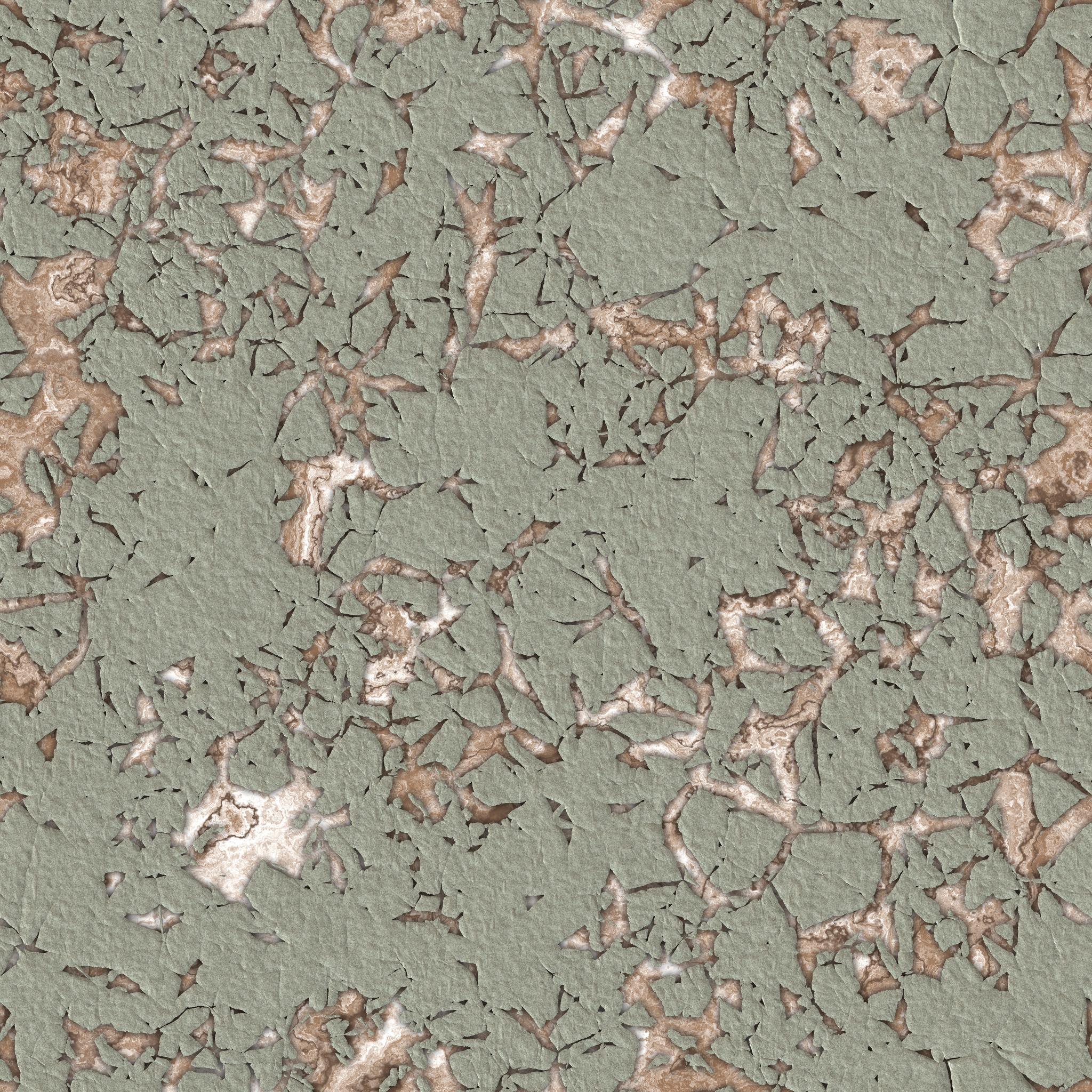

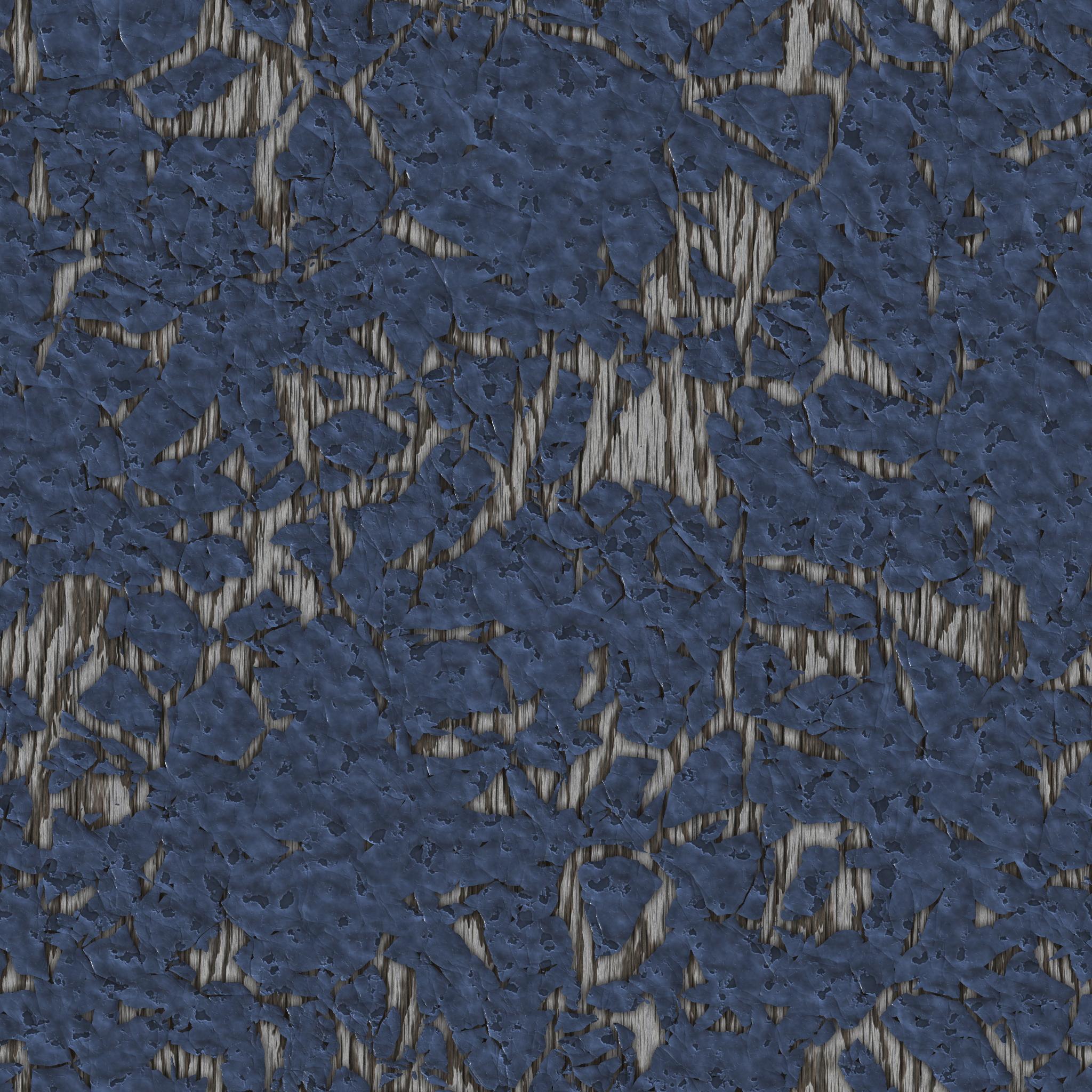

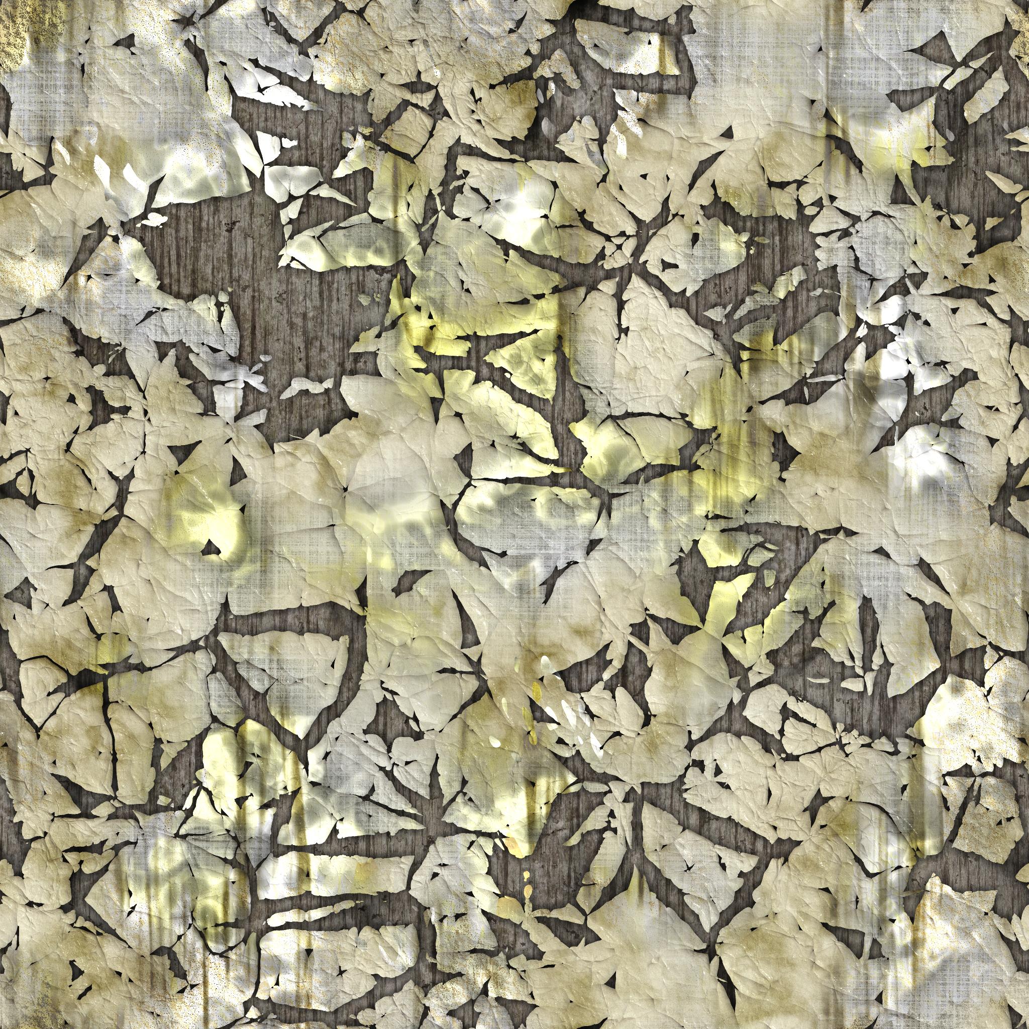

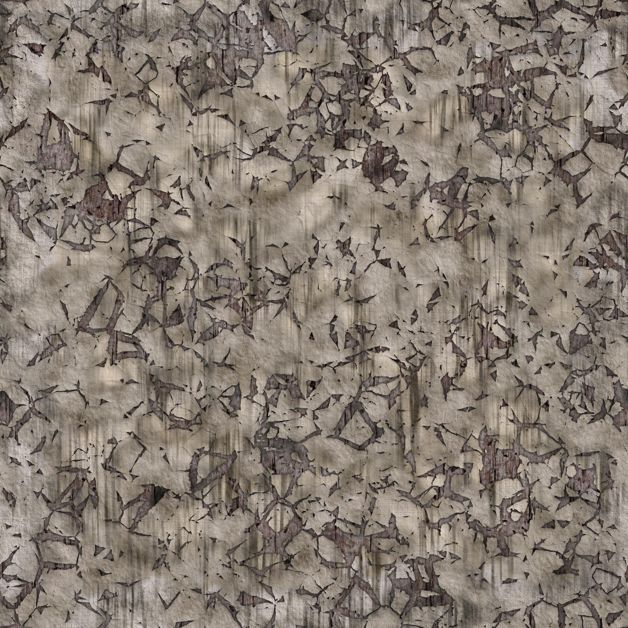

    I know you are looking for a pre-made shader and this isn't what you asked for, but Filter Forge has several filters which could produce a PNG alpha layer of a paint layer to use on whatever base layer you'd like...
    Here are some examples of what you can make...
    These are all made with Filter Forge and are seamless, so if you open up the thumbnail you can download it at full 2048 x 2048 resolution.
    The second and the last are peeling paint over a marble, the rest are over old wood.
    2048 x 2048 - 4M
    2048 x 2048 - 4M
    2048 x 2048 - 4M
    2048 x 2048 - 3M
    2048 x 2048 - 4M
    2048 x 2048 - 4M

    Thanks, I'm glad you like them... To be clear, just so you understand how those were made...
    For example, I'll pick the second from the top...
    First I chose a filter that produced something that looked like a painted surface... in this case "Baked Paint" https://www.filterforge.com/filters/5096.html
    Then I fiddled with the filter's controls a bit and rendered it out as a Jpeg to 2048 x 2048... (BTW- whenever you want a seamless texture be sure to tick the "seamless" box, in the controls section, as not all filter creators who specifically make a seamless filter remember to enable that before they publish it)...
    Next I opened the filter "Peeling Paint" https://www.filterforge.com/filters/295.html and messed around with the variation and size a bit until it looked sufficiently close to what I wanted and then I opened up the "Baked Paint" image I just made in Filter Forge...
    Some filters are designed to generate a texture or pattern as an image (Texture Filters), but others are designed to take an rendered image and generate a version of it with an effect added to it (Effects Filters).
    In this case "Peeling Paint" takes the input image and make the input image look as though it has cracks and missing chunks...
    I played about with the controls a bit... altered the damage/chips/peeling amount, as well as scale and turned off the background (this filter allows you to shut off the background so you can render the final image as an alpha layer with missing sections) and rendered out a PNG alpha layer version of the Baked Paint image, that now looked battered, cracked and peeling...
    Next I chose a simple marble filter, "Marble Maker" https://www.filterforge.com/filters/15667.html
    I fiddled a bit with that too, but basically not much and I rendered out a 2048 x 2048 Jpeg image of those results...
    Finally, I opened the marble image in Photoshop (any image editor will do) and then imported the Peeling Paint layer on top, made sure it was all lined up and then flattened the image into a single layer and saved it as a Jpeg.
    I didn't bother to make normal maps or bump maps in this case because it wasn't necessary (both of the "paint" filters involved can generate bump and normal maps, but not all filters do and not all do a great job), but to achieve a proper effect where you have one type of texture on top of a different one, it would involve a few extra steps... and it's not necessary to describe that at the moment.
    This is all actually pretty easy and once you get used to it, pretty quick and usually well worth whatever effort involved.
