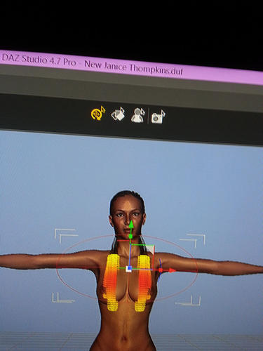

I've tried looking how to deform my hair poking through my models breast on Daz, i've searched Youtube to watch videos of those who may have the expertise but i couldn't plus their Daz program was outdated to mine which is 4.7 so i couldn't get how to fix my poke through with hair poking through my Victoria 4.2 breast even the author of one video was nice enough to direct me here so hopefully i can get to the next level. My problem is urgent i searched to the 3rd column i can't search more please help me!!!!
1000 x 1333 - 214K

    You need to shrink and move the Field part of the DForm so it encloses the hair you want to move (that's easiest before posing), with the red dots where the poke-through is worst and fading to green where it's least bad. It may be easiest to do each side separately. Then it will probably work to select the actual DForm (the bits that's parented to the base) and just z translate it (move it forward). You can then adjust the field to get the effect you need.
    If you are using Windows 7 or later, use the Snipping Tool to take a screenshot rather than taking a photo of the screen - it will be more legible. Type Snip into the Start menu, or the Start screen for Windows 8.

    Okay cool i will try it thanks for the reply
  • daperfectblackdaperfectblack Posts: 2
    I DID IT!!!! Thank you you will be my new ally for this thank you again
