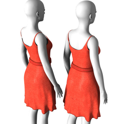

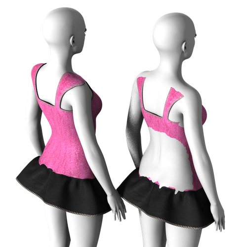

    Ok, here's G2F wearing Fan Service dress - no morph on the left one, 'Youth Posture' at 100% on the right. The morph effectively straightens up the body posture so the lower back goes back a bit and the shoulders go forward and up.
    Most clothing follows this morph (and the others showing the same problem with this clothing and Romper) even without specific FBMs in the clothing.
    500 x 500 - 222K
  • Design Anvil - Razor42Design Anvil - Razor42 Posts: 1,250
    Is there a smoothing modifier applied to the items?
  • CzexanaCzexana Posts: 167
    Yes, but only 2 iterations. If I crank it up to 25 then, yes, the cloth covers the back. But the front is very loose at the waist.
    Smoothing can hide the problem to some extent here, but then why does the Hipster Librarian dress (to choose another item from the same authors) follow the morphs correctly with no smoothing applied?
    500 x 500 - 219K
