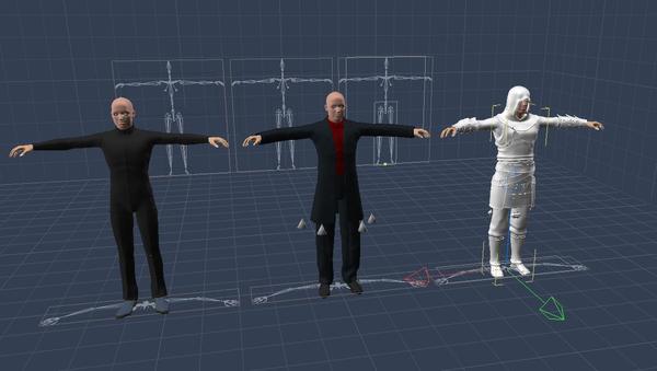

    Unfortunately, I think these types of problems are item specific. I have had my share of poke through, and even far more successes. However, I can't find a pattern for which legacy products work well with genesis and genesis 2 and which do not.
    As for Michael 4 specifically, I am attaching a screenshot of three products that were designed for M4 that I have had little to no trouble using with Genesis. They are the ValSlicer from here at Daz, The RP Zoot Suit, and the Uzelite M401 outfit. Yet I have had other products behave similar to what you report.

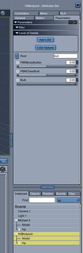

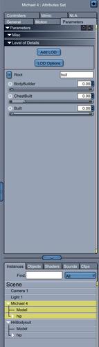

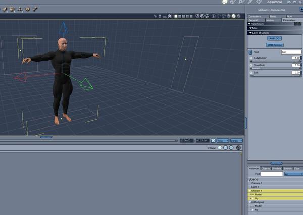

    I'll try to show how it is supposed to work, then I'll show one way to address it in a second post.
    Well, here is how it might work if the clothing creator has put the appropriate morphs in the item. Sometimes, you will find morph injections in the pose folders. Under the "content" tab in the browser, open the My DAZ3D Library Runtime folder (emphasis on the word "Runtime" ). There should be subfolders labeled Faces, Figures, Hair, Hands, Poses, and Pops. In the "poses" subfolder, check to see if the clothing item that you are using has its own folder. If so, check to see if the folder contains any "inj" poses. If so, click and drag the "inj" file on to the clothing item in the instances tab (lower right) and it will load the morphs. I doubt that such files exist for your product, but sometimes they do and you should check before going to a lot of other trouble.
    Assuming that no morph injection files exist, lets carry on.
    First, here is how it would work if the clothing had the morphs (either built in, or available as "inj" poses).
    - load the base figure (M4 in this case with its morphs) in your scene.
    - load the clothing item in your scene. If sold by Daz, sometimes clothing items for M4 and V4 will have "unimesh" in the name if they have the morphs.
    - With the clothing selected, under the general tab, and then under animation group, choose "fit to" and choose M4.
    - The clothing will conform to the figure.
    ** in the attached pics, I loaded M4 and a clothing item that I know has some morphs, the H4 bodysuit. If you look in the screen grabs, you will see that a bunch of morphs will appear in the upper right when the item is selected. I have put "build" in the search box so that you can see similar morphs (bodybuilder) in both lists.
    - Select the base figure (M4 in this case) and increase the morph dial by entering a number or using the arrows.
    ** in the attached pic, I increased bodybuilder morph for M4
    - The clothing item also morphs to conform to the base figure
    ** in the attached pic, note how M4 increases in muscle girth, and the bodysuit does as well.
    OK, your clothing product is not doing that, so in a later post I will show one thing that can be done.

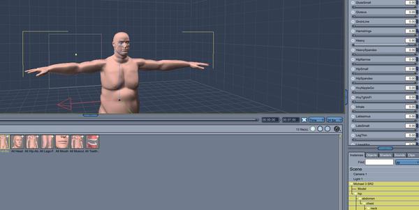

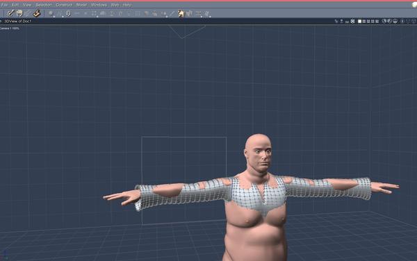

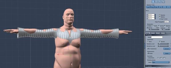

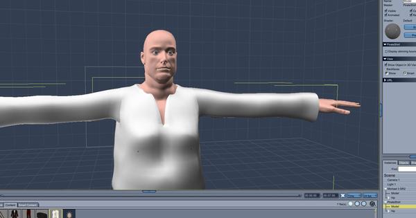

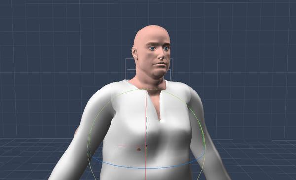

    Well, I actually had a hard time finding some M4 stuff that I owned that didn't have the basic morphs. So I will show one very easy way to address this (an inelegant way) for generation 4 and earlier content in Carrara. I am going to use a Michael 3 example because I gave up looking for M4 clothing without the morphs.
    ** this is just one way, and it is NOT necessarily the best way **
    OK, I loaded Daz Michael 3 and applied morphs to it.
    - I this case, I made Michael 3 fat by using a morph called heavy.
    - I then loaded an M3 pirate shirt that did not have that morph.
    - I conformed (fit to) the shirt to M3 and you can see that the shirt is too small now.
    - I then selected the "model" level of the shirt in the instances tray (lower right).
    - I then clicked the wrench icon in the top left menu in order to start modeling in the Assemle room
    - The shirt appears to change to a bunch of polygons.
    - I then used Carrara's modeling tools to select the lower portion of the shirt (which was hard to see but easy to select :> ).
    - Making sure that the box for "soft select" was enabled, I moved the shirt's polygons outward until it better fit M3.
    - I then clicked the wrench icon again to finish editing
    - I then posed M3 and the shirt still fits.
    Hooray! In Carrara, you can directly adjust the meshes of the clothes in the assembly room! For M4, V4, etc., this is very easy and painless. Unfortunately, Daz has chosen to protect the topology of genesis-related content. Aaargh.

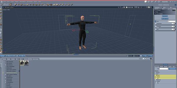

  • eponicaeponica Posts: 197

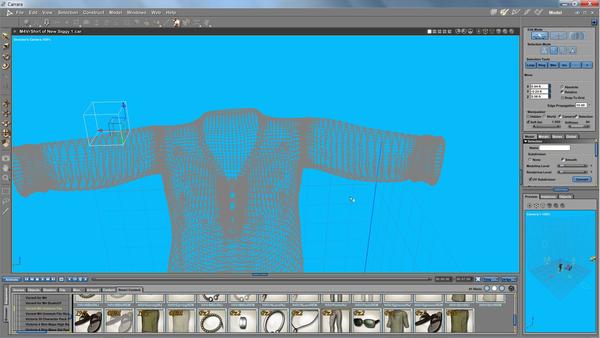

    Diomede, your instructions worked perfectly! :-)
    I injected all the morphs I could find for the outfit, but none worked for my figure. So I used the vertex modeler as you said, and it really Was painless! In a couple of minutes I had a perfectly fitting shirt!
    You know, I really like being able to tweak clothes like this. Right away, this makes me feel a lot more comfortable than just depending on a fitting tool. But I guess this won't work with Genesis stuff, correct?
