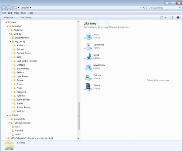

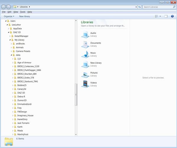

    Here is are my folders --- Notice in the public folders - there is nothing in the data folder
    Nice in the LexLuthor folders there are files in the data folder.
    The drive is H:\
    Please, look at my folders and see if you can sort out what I should to to salvage the installation of approximately 45GB of content files
    for use in Daz3d and Carrara. I appreciate your help. I still cannot get past the permissions problem to study the install manager documents.

  • fixmypcmikefixmypcmike Posts: 19,718
    You don't have to use the default, but whatever location you use, you need to add inside DAZ Studio so that DAZ Studio knows where to look.

    Towards the bottom of the screen captures you will notice
    users/Public/Public Documents/Daz 3d/My Library/data - the data folder is empty.
    This is where I have settings in installer manager to install
    users/lexluthor/Daz 3d/My Library
    The folders are placed as they should by installer manager and the data folder is full of files
    users/lexluthor/Daz 3d/My Library/data

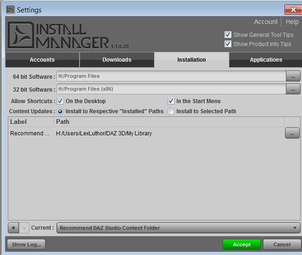

    Here is settings window from Install Manager
    If you need additonal screen captures - let me know what you need and I will respond.
    Is there a way to do any edits inside Daz Studio? I tried the content management, and it does allow edits...but not the data\ folder pointer.
    You want the same path that you show in DIM, up to My Library. In Content Directory Manager, highlight "DAZ Studio Formats" and click "Add" to add the path. You can remove the previous paths if you don't have anything there. Do the same for "Poser Formats".
