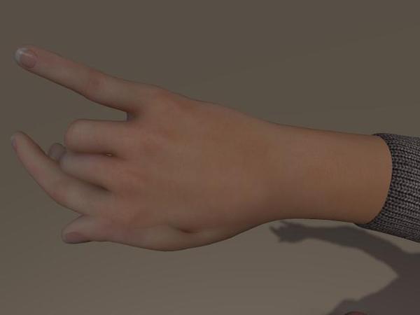

Maybe and old problem, but the Genesis Hands are messed up in Poser! If I try to bend the fingers or use the grasp dial and the finger parts are moving in some directions but not in that direction I want them to move. It looks like if I use the bend option they move in bend and site direction together.

    Which version of Poser? If it's PP2014/Poser Game Developer or possibly Poser 10 do you have SR5.1 installed? SR5.1 seems to be causing some issues, including broken fingers in at least one report I've seen.

    Hm, I found out that the left hand works properly, but the right hands doesn’t, I’ve got the Idea, to go to the “symmetry” options in poser and chose “left arm to right arm” at next there is the a popup window “Do you want to copy the joint zone’s setup also? This option is not undoable” I select yes, tried the hand and finger movement….. And voila, it works again!!
    Something must have messed up the joint zone setup of the right hand!
    If someone has a similar problem, I suggest making a copy of you Poser file before you copy the joint zone setup of your Genesis figure, as it stated “that option isn’t undoable”!
