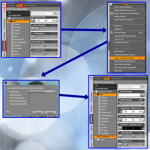

    It's not on the right-click menu, it's in the options menu which is an icon on the side of the panel that looks like a series of lines and a triangle. In there you'll find context-sensitive options for the parameters, including the lights. In the surfaces pane, the same icon is used to access the material options for Luxus.
    1000 x 1000 - 603K
    Post edited by Herald of Fire on

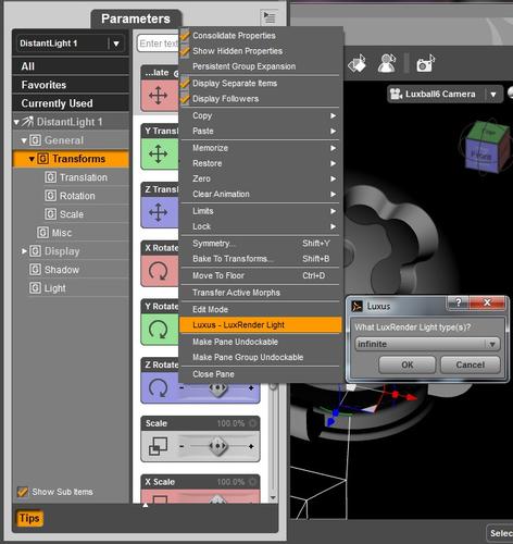

    If you want to transform a surface to a light source HeraldOfFire is right.
    But if you want to transform a DAZ Studio Light to a LuxRender Light, you have to go to the Parameters Tab and with Right Mouse Button it should look like the screenshot attached.
    668 x 707 - 126K

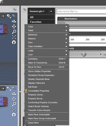

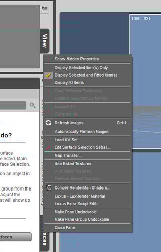

  • ginniginni Posts: 3
    Thank you both for your answers.
    I do get Luxus material on the surface tab fine.
    but Not on the parameters tab and I find that annoying as the program is useless without it
    I reinstalled DAZ studio and Luxux but no joy.
    Please does anyone have any suggestions why luxus does not show on my parameters tab. it say it is compatible with Studio 4.7

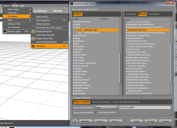

    Try this:
    - Go to the Menu Window => Workspace => Customize
    - On the left side in Actions try to find Luxus => Luxus-LuxRender Light
    - On the right side in Menus try to find Parameters Pane Menu and expand it
    - Drag and Drop the entry LuxRender Light from the left to the right to the entry Parameters Pane Menu
    - Click on Accept
    Maybe thats the solution?
    1020 x 740 - 481K
    Post edited by MN-150374 on
