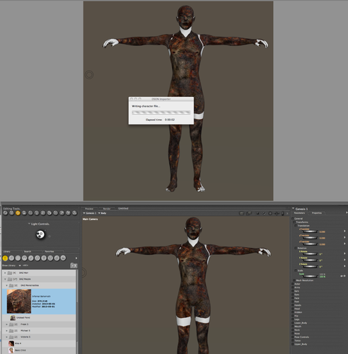

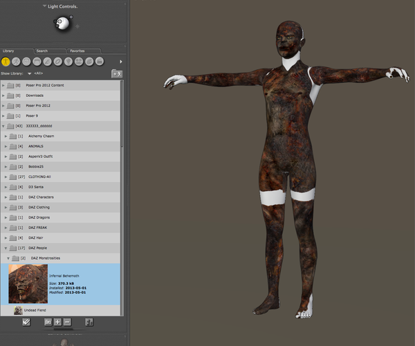

  • FauvistFauvist Posts: 2,291
    edited January 2015
    If I look at the first screencapture, it would seem to me that DSON is installed - and it's working or something. The 2nd screenshot shows the result. In the Genesis 1 Parameters tab, is there a dial hidden somewhere that I'm suppose top turn to get the Infernal Behemoth to show up?
    1329 x 1350 - 524K
    Post edited by Fauvist on
  • Richard HaseltineRichard Haseltine Posts: 111,992
    Did you install both the DSON core and the Poser CF files for the Monstrosity? If not you won't have the UVs or the morph, which is what your screen shot shows.

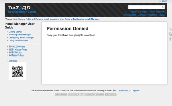

    I tried to find out how to change the path for the content installation, and I get this message:

  • TheWheelManTheWheelMan Posts: 1,014
    Fauvist said:
    Fauvist said:
    The contents of the "Content" folders from the zip is what goes in your Poser library location - the runtime merges with the existing Runtime, the Data folder goes alongside the Runtime folder (you probably already have one from the Genesis base files, so it merges with that). This is much easier using the Install manager, as long as you point it to your Poser content library folder.
    I've been trying to install this figure and get it to work for 5 hours.
    I did use the install manager. It installed the files in a completey different place. I'll reinstall the install manager and try and point it to Poser.
    Maybe try logging in to DAZ first? I see "login" at the upper right corner.

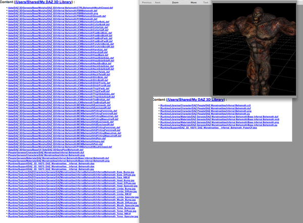

    In Poser I'm clicking the Behemoth icon - not loading Genesis first. I've attached a screenshot of Behemoth that I opened in DAZ Studio - which seems to load fine. I've attached 2 lists - the firs is the locations where the Installer put all the Behemoth files, the 2nd is where it put the Poser Companion files.

    Fauvist said:
    Looking at this, I have to say that none of my other Poser files are installed in /Users/Shared/My DAZ 3D Libarry
    The Poser files are mostly just reference files, Their primary function is just to put links to DS's .duf files inside Poser's Library for convenient loading. So all of the files are there. The Importer just isn't loading them properly for some reason.
    Can you double check to make sure that the "Users/Shared Data/My DAZ 3D Library/Runtime" folder is listed in Poser as one of Poser's runtime libraries.
    To change the install location in DIM click the gear icon in the top corner and go to the Installation tab, then click + to add a folder (remembering that you want the folder that holds the Runtime and/or Data folder). Then to make sure the right folder is being used, click the details box in the main DIM interface and you should get a drop-down list to select from. Ideally you want all the Data folder items in one Poser content library.
