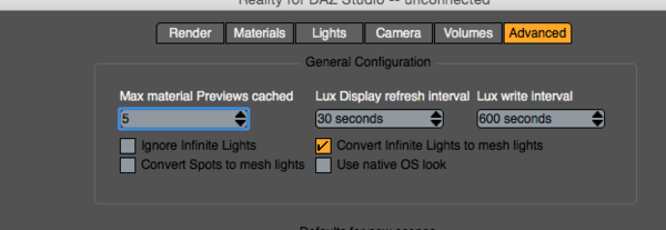

    Also try changing the Tone Mapping from Audio Linear to Linear (see screen shot) which will give you more control over your scenes lighting.
    You should let Lux run until you get to at least 1000 s/p which can take several hrs. It's not unusual for a render to take 10 hrs or more depending on your machines specs.
    Also under the Advanced Tab in Reality try changing the Lux Display Refresh Interval to something like 30 seconds & Lux Write Interval to 600 seconds (10 mins) as this will help to cut down the rendering time (see 2nd screen shot), These can also be changed within LuxRender's main window as will.

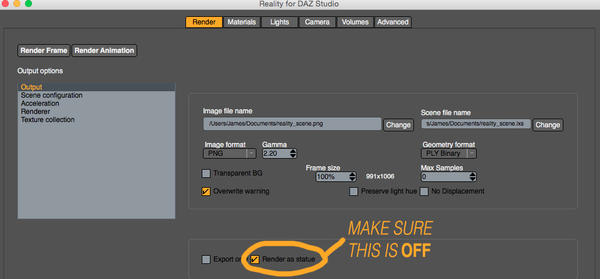

    In addition to lighting the interior check that you have turned the following option UNCHECKED
