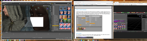

    2) Thanks - I received a reply from DAZ support and it's in the product library where you open an icon and the interface comes up but so far, though I'm following the tut specs such as turning on the green SSS materials icon, the character materials are all off and I get a white figure.

  • Richard HaseltineRichard Haseltine Posts: 111,984
    Please post a screen shot of the Skin Builder dialogue after setting your options.
  • NW316NW316 Posts: 79
    Hopefully this will be large enough to view.
    2000 x 562 - 967K
