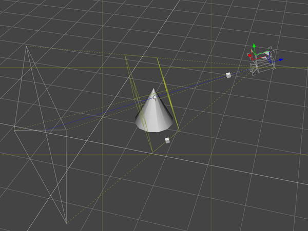

    to activate Fs/stop, you need to active DOF (Depth of field), but as it was out of focus, you probably did that.
    To see what you are doing, look through the "perspective Camera", then select the camera, and you will see two "planes", near and far and a small ball (focus point), now you can adjust the camera to focus on the object you want.

    Thanks, that looks remarkably simple.
    I will give it a try as soon as the oof render is finished (sometimes a "wrong" photograph has some merit so I will see what appears - likely nothing but worth a look.
