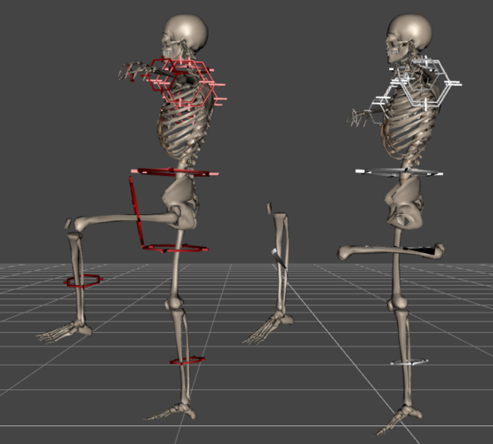

I have tried to do this using the figure setup tab and then the 'copy from selected figure' option. It lets me change the hierarchy as I would like to, but when I create the new figure I lose all parameter limits and also the events handlers that are accompanied with the figure don't do what they should. I have added a screenshot from the program to illustrate what's happening. The left figure is the original and the right the new one. In both I have changed the left leg positioning with the event handlers but the behave completely different.
I have tried to solve the problem with the transfer utility and only changing the weight maps but this also doesn't seem to work but this might be that I use the wrong settings.
Is there a simple way that I can change the hierarchy of an existing figure without having to completely redo al parameter settings and event handler settings?

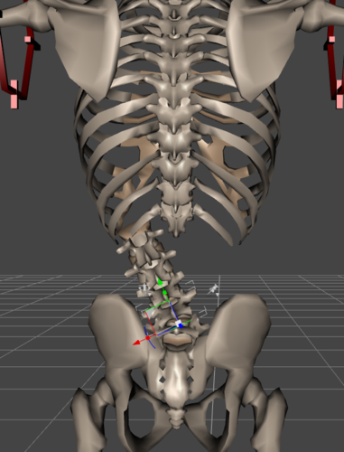

    I want to change the positioning of the individual vertebrae as in a real human body but when I change the parameters of the lower vertebrae I lose the connection with the chest (see picture). I have looked at the current hierarchy and the problem is that the parenting isn't correct (the chest should be a child of the vertebra just beneath it).
    If there is another way of dealing with this problem then it would also be very helpfull

    The bones should pose as the figure is posed - there are links from the standard body parts to the individual bones so that they do bend instead of deforming. That's why they are on their own branches of the hierarchy instead of being linked in a chain all the way up. If, for example, you take the zeroed figure, bend the abdomen formward, and then click through the l5 to l1 bones you will see that each is bending on its own.
