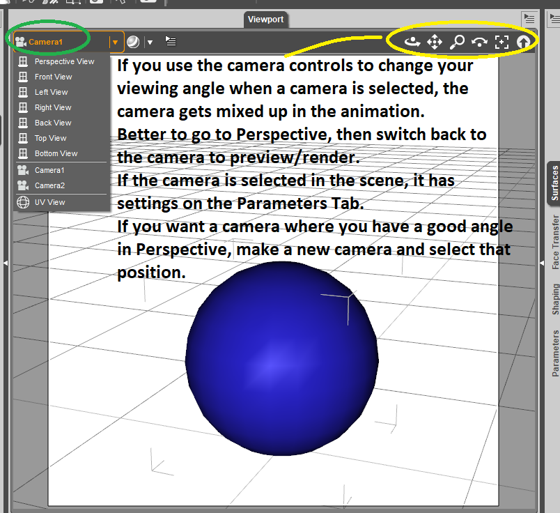

     It is rather important to switch back to Perspective view when making changes not to affect the camera ;-) Then switch back to the camera [or make a new camera] through which to view the action.

    Hope this helps.
    1173 x 834 - 159K
    804 x 736 - 137K
