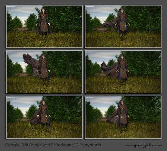

  • JoepingletonJoepingleton Posts: 746
    See the animated version at http://youtu.be/oCUN69fX9y8
    This is another experiment in getting Carrara's soft body modifier to work with DAZ clothing. I used Wildenlander HD for Genesis 2 Male cape on a walking Genesis figure. This technique is pretty limited, good for capes and such. It didn't work on dresses or full body clothing. :(
    633 x 573 - 164K
