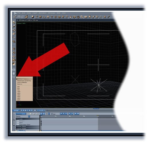

    I'm not sure if this will correct your issue, but here is what I would try first:
    Go to the tools on the left (unless you've moved them) and click the drop-arrow by the magnifier > choose "Default Zoom"
    1333 x 1210 - 735K

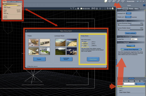

    Also under View there is the production frame properties.
    Tip:
    Scene "Magnitude" has everything to do with how your mouse wheel zoom behaves.
    In the Scene's "Interface" tab, you may also edit this behavior.
    * Large Scene Magnitude - one mouse wheel click covers a vast distance
    * Medium Scene Magnitude - one mouse wheel click covers a medium distance
    * Small Scene Magnitude - one mouse wheel click covers a tiny distance
    This is to help make scene's more navigable depending upon the project at hand.
    Scene Magnitude may be set in two places:
    File > New > New Empty Scene Dialog selection
    and
    Scene > Interface Tab (select "Scene" in the lower right panel) - the tabs are at the top
    Using the Scene's Interface tab, you may also change the magnitude of the scene as well as other aspects of this behavior, though I have always preferred to begin with a new scene of the appropriate magnitude, rather than to change in the middle of a project - even if that meant that I had to start over. But that's just me.
    1224 x 805 - 706K

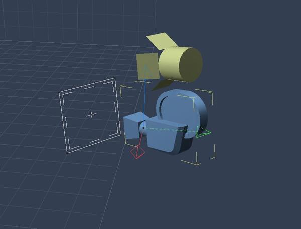

    Anyway, what I do is jump over to the Director's Camera view, and select the Main Camera in the instances tab, hit "0" and you'll see the Main Camera, including the production frame. Then you can adjust the production frame by dragging its corners like you normally do. Just keep making it smaller, then jump back to the Main Camera and re-adjust as you want it.
    With this method you just need to zoom out in Director's view as much as you need so you can grab the corners of the production frame, and then adjust it all in one step. Much easier than 10 minutes to do 50 moves.... :)
    Here's what you'll see when you're in Director's Camera view, looking at the main camera.
    904 x 688 - 46K

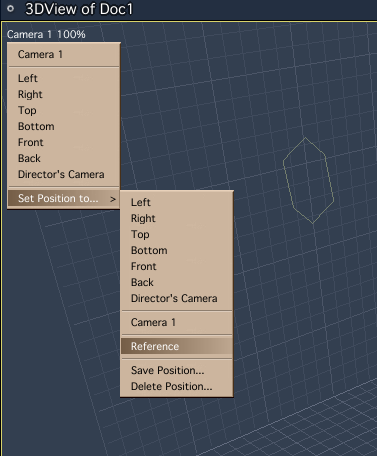

    You could also reset the camera by sending the camera back to its reference position.
    The best way to avoid camera wonkiness is to not use 2D view controls on a 3D camera. The zoom, and hand icons (below the camera/spot render) icon are really meant to be used with the isometric views, such as Left, Right, Front, Back, etc.
    Also as has been mentioned, when building your scene it is best to utilize the director's camera. It doesn't generate keyframes and if you use the 2D view controls it won't screw up the production frame.
    It may also have been mentioned that you can save your camera positions. These are accessible to every camera in the scene through the pulldown menu in the screen shot.
