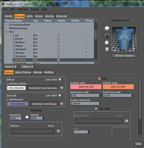

I just upgraded from Reality 2.5 to 4 for DAZ Studio, and got the newest version of LUX render as well. I was hoping with the new set up it'd be easier to adjust settings and such, but I feel like I don't know what I'm doing. I have two main problems.
First, I am trying to render a Na'vi in the forest, but his skin won't stop being super shiny--even though he's on skin settings.
Second, I have 3 regular distant lights and a sun light to my scene, and a couple mesh lights--I figured the more lighting, the better for the render, but I still get a lot of noise, even after trying to follow a tutorial (here: http://preta3d.com/kill-the-render-noise-form-your-lux-scenes/) about adding mesh lights to down the amount of noise.
Mostly, I'm annoyed by the skin problem, and if anyone has a suggestion, it'd be great. I've seen another thread on here about skin in LUX, but I don't know how people are getting all those menus up. I can't locate them at all--and the screenshots look like they're from DAZ, which confuses me more >.> Anyway, I'm hoping a user of Reality 4 would have an answer... I would be most grateful.

    Oh, and the setting in Reality...
    EDIT to add: I adjusted the sunlight, which has seemingly taken care of the skin problem, but I still do not understand why I have so much noise in the scene...

    I don't use Sun much, but I've heard people say the sun light is more noisy than meshes. Many people avoid using it because it is also very harsh and can make skin look quite nasty. I would suggest replacing this with a mesh light. What I do is to position a mesh in the air (say about 6 metres) pointing down at the subject from the direction I want the sun to come from. There is a setting in the new R4 mesh lights in the Shadow Control area called "sharp" (I think). This scales the mesh right down so that it will give more sun-like shadows.
    I would add no more than two soft (large mesh) mesh lights. For example one on each side of the camera, on approximately the same plane as the camera, or behind, and pointing in towards the subject (2-point lighting set up used in photography), but of course you can try various positions (including a top light which can be quite effective).
    Although you do want light to reach the subject, adding too many lights will slow down the render because calculations are needed for every light source, and really, much of this extra lighting is unnecessary and will be wasted.
    On the skin, because R4 uses "SSS" by default and this set up (which uses volumes) takes longer to render, you will find your skins initially more noisy than using simple gloss (as in R2.5). I'm afraid this means being even more patient. As long as you have good lighting the noise will clear up.
    On this particular skin set up I see the specular colour is quite high. It looks equivalent to about 50% grey or more. Even with spec maps I wouldn't have the colour that high, unless it is a very dark map. This is likely to be contributing to the excess brightness of the skin, so try bringing this value down to 30% or 25% even, i.e. bring the slider in the colour picker down to a quarter to a third of the way up from 0 (pure black). I can't be sure what's likely to work without seeing the map itself.
